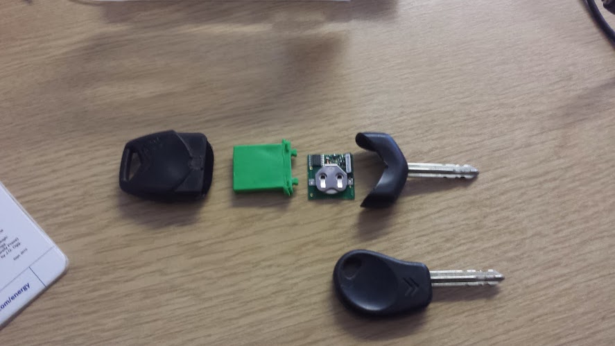

on the circuit board.. there is a wound core (shown as a white cylinder in pic).. that has lost contact.. could well be the problem, but my soldering is useless..
would this be a good time to grab 2 used keys, and the four locks and get car back to RCL? I know/guess i will lose alarm but not sure it works anyway.. or am i opening a worm can? :shock:

Be careful John - you can't code a used key to the immobiliser, the chip is a one shot job. Not sure where the chip is, and whether changing the blade over will move the chip over? But then you haven't got any blades that will fit a Std Key. I have recently found a supplier for new keys for our C4 on e-bay, (£30 uncut), so I am going to buy one as we have manged to lose the spare :roll:
