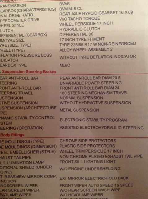

I joined the citroen service site to get info about my car, does this printout mean I don't have hydropneaumatic suspension as it says metal suspension. I know it's not hydractive but what type do I have?!?!

I'm confused Matty, do you have hydractive suspension or the regular suspension?
It just has standard suspension, not the active stuff where you can change it

Re: Help with awful c5 suspension.....
It is regular suspension. To see it for yourself you only have to open the bonnet and see that there are no spheres.

Looks like a steel-sprung car to me.
In that case H&R do a lowering kit for about £250 which will make it harder and stiffer.
