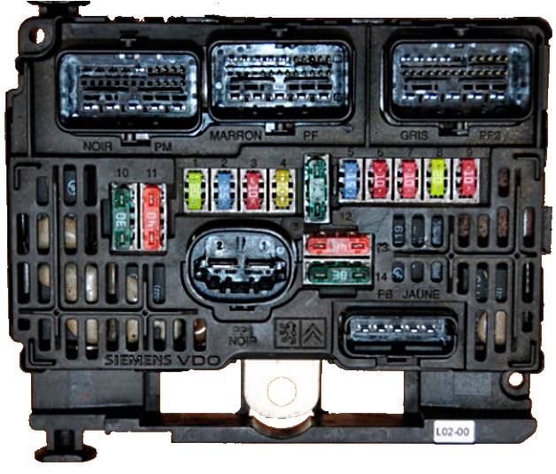

VertVega
- Posts: 1178
- Joined: 01 Nov 2008, 19:39
- x 13
Re: Headlight washer-pump AND fluid-level indicator not work
I hope this pic can be used as a reference to locate the pins of the connector
The headlight washer pump fuse is number 4 as I mentioned above which you have already checked.

Axa
- Posts: 166
- Joined: 11 Sep 2010, 19:04
Re: C5 headligh washer pump AND fluid level indication not w
Thanx allot. I can't find any Green 16pin plug. There is 3 black/Brown 28pin plugs. Marked (from left to right in the photo above) NOIR PM. MARRON RF and GRIS PP2.
They have 9, 18 and 17 pins in use.
The one with 17 cables connected have 2 of the cables twisted. Could that be the 16pin plug?
Sent from my LT25i using Tapatalk

Axa
- Posts: 166
Just discovered the "base" of the 28pin plugs are also colored Left to right --> Black, Brown, Grey .

wheeler
- Posts: 7938
- Joined: 21 Sep 2002, 19:07
- x 1061
Maybe stempy is referring to a mk1 C5 ? The under bonnet fuse box is totally different, the one shown in the pic above is from a mk2 C5 (with full CAN multiplexing). The mk1 does have a 16 pin green connector on the under bonnet fuse box.
VertVega
- Posts: 1178
- x 13
These basic french words became familiar to me from my Xantia daysAxa wrote:...plugs are also colored Left to right --> Black, Brown, Grey
Noir - NR - Black
Marron - MR - Brown (Chestnut)
Gris - GR - Grey
Blanc - BA - White
Blue - BE -Bleu
Vert - VE - Green
Rouge - RG - Red
I hope you'll find the solution and write us the results.
PS: Just read wheeler's post, C5 mk1 (C5 I) is fuse box is different.
This one is valid for mine and also should be same as axa's C5 II.
Stempy
- Posts: 1626
- Joined: 26 Feb 2004, 23:21
Yes, that picture does look different but the diagram on SEDRE look the same for phase 1 & 2. The RPO number would confirm I guess.wheeler wrote:Maybe stempy is referring to a mk1 C5 ? The under bonnet fuse box is totally different, the one shown in the pic above is from a mk2 C5 (with full CAN multiplexing). The mk1 does have a 16 pin green connector on the under bonnet fuse box.
