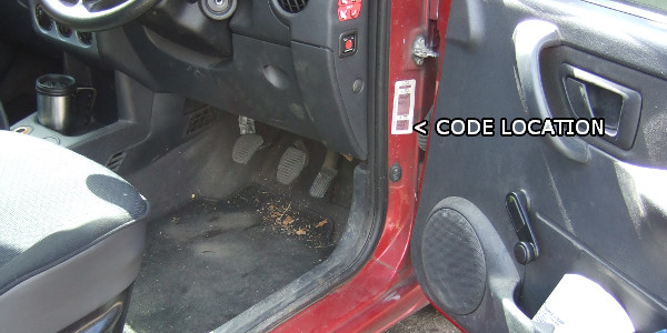

Is the paint code on the car somewhere?

For most recent Citroens, although it can be in a different door shut occasionally.
Yours may be under the bonnet though, on the inner wing or firewall.
More info here
