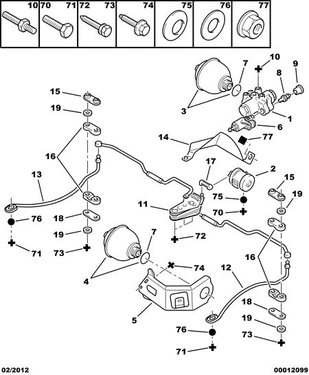

Following is a diagram of Suspension Rigidity Regulator for an Activa.
There are two pushrods (Nos 12 and13 in diagram) connected to a hydraulic control lever, No 11 in diagram. Also there is a Hydraulic Height corrector mechanism, No 2 in diagram. I believe something there must be damaged or has lost its adjustments, caused by exhaust forward knock.
But until start to dismantle it, I'll waiting the opinion of activa doctor Mr Jim.
Here is the diagram:

Xaccers
- Posts: 7654
- Joined: 07 Feb 2007, 23:46
- x 188
Re: Xantia Activa doesn't rise normally The left side stays
Part 14 is the heat shield and on mine it was bent which stopped the height corrector working in one direction, so would be worth checking that it doesn't interfere on yours.
