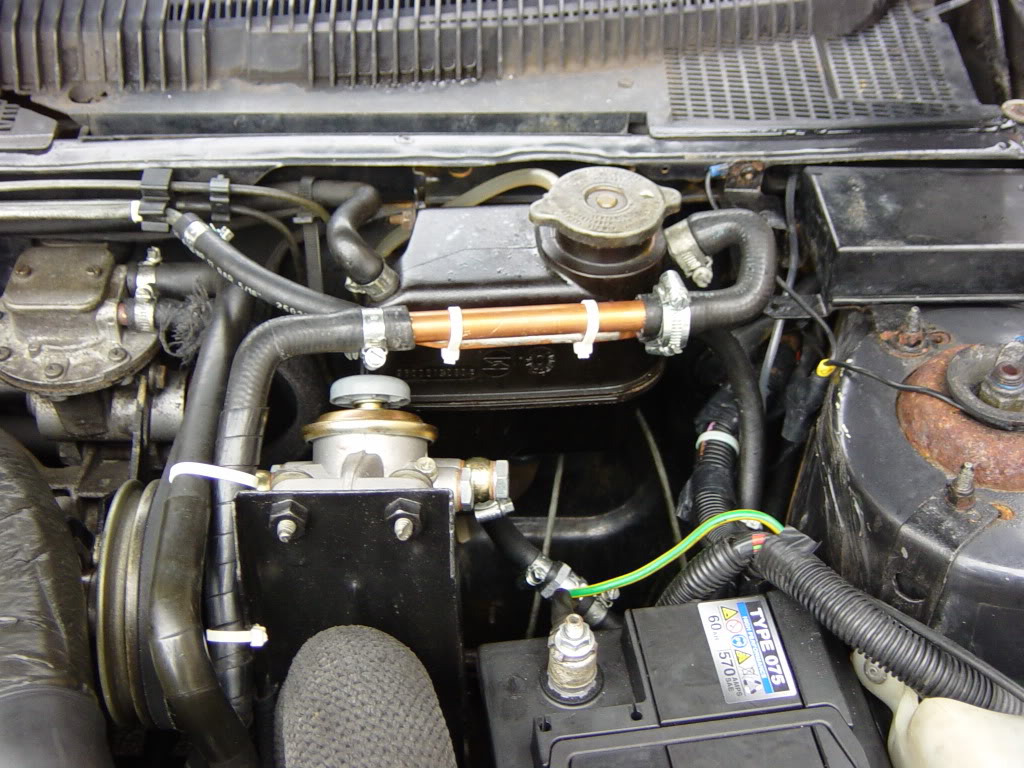

Spider you mentioned the fuel heater there, that's where the fuel lines run into from underneath the car and warm water circulates yes? I had to bypass this and go straight to the primer housing as I was drawing major air from it and the engine was revving like mad. Should I still be using this??Will it make any difference on start up as the water that circulates it will be cold anyways? I just replaced the glow plugs for all new Bosch ones and no difference

It won't cause any problems until it wax's the fuel (not quite yet) I made one from some microbore piping, I'll try to find the pics later.

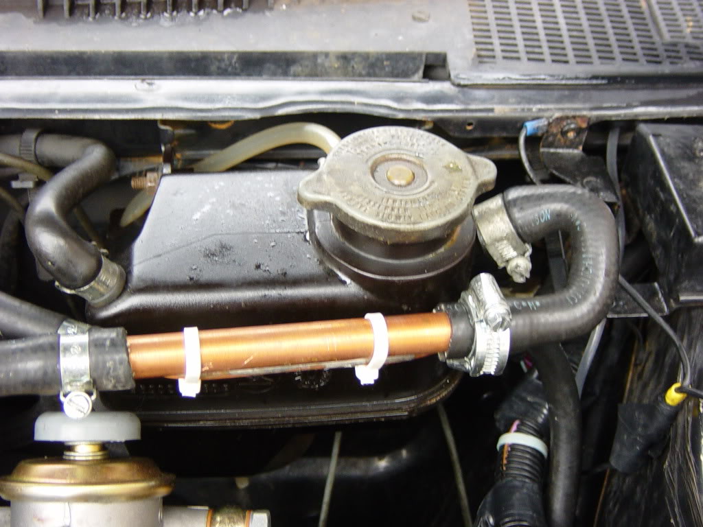

Re: Rought start up with white smoke
Fuel heater (the top hat unit will not fit on the 205DT unless you want to do away with the oil cooler, been there tried)
One large one small pipe, cleaned and soldered (yes its enough it does not get that hot!) together for max transfer:
Fitment:
Fitment:
Yes that's a good point I had to replace mine, you see the one in the pic is a third party one (a brand new Ford one iirc) although it was 100% fine, took spin on cartridges (much easier and less mess than the internal paper element job too)
You'll notice the one way valve (to the right of the filter in the pic) this is because I was chasing a poor start condition, the one way valve fixed.
I've started to miss that car more and more lately
I had it for 7 years (!) which is a record its usually a year or at most two between a change. It was still 100% at near 200K (only just run in) very powerful (relatively) and was about spotless no oil leaks etc)
