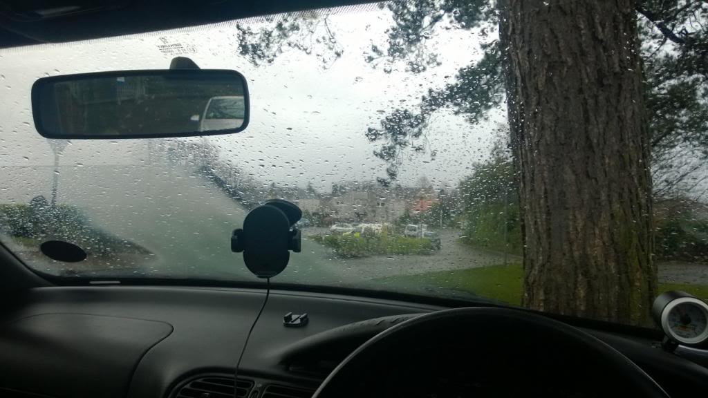

For a while now I've noticed that my windscreen has a tendency to mist in one particular area:
Is this a sign that the heater matrix is leaking? The car doesn't seem to lose any perceivable amount of coolant. There isn't any odd smell but it does take the AC a while to shift it. Most annoying.

The picture above was taken when the car was parked up for 2 hours, screen was clear when I parked. If I switch off the AC it usually comes back :(

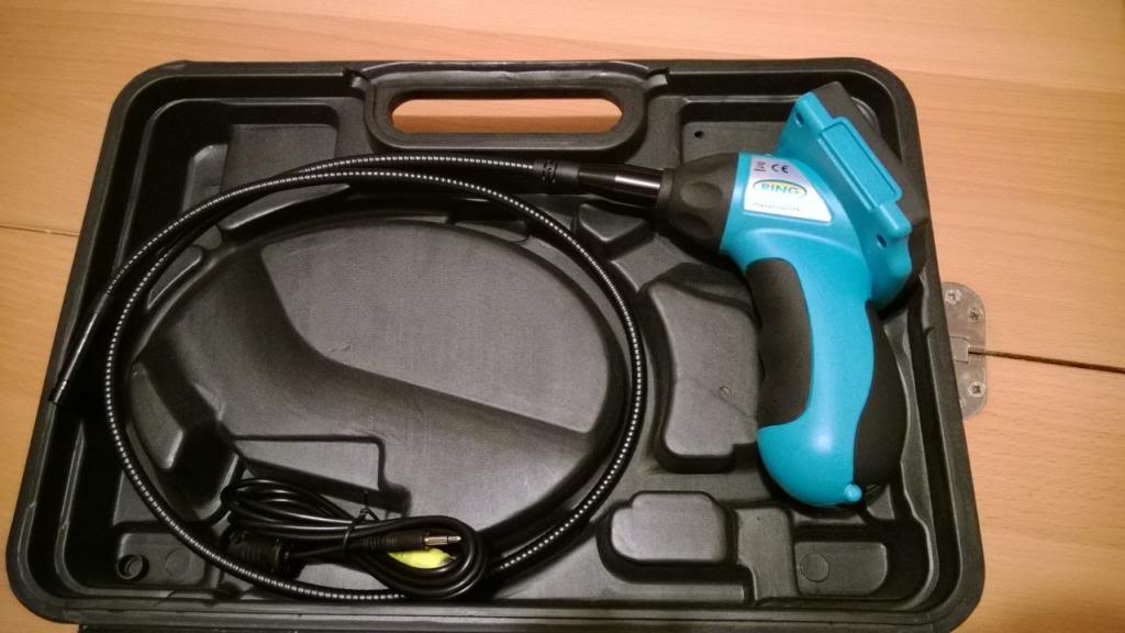

Thanks Andy, this evening I put to good use one of my Christmas presents, a borescope inspection camera:

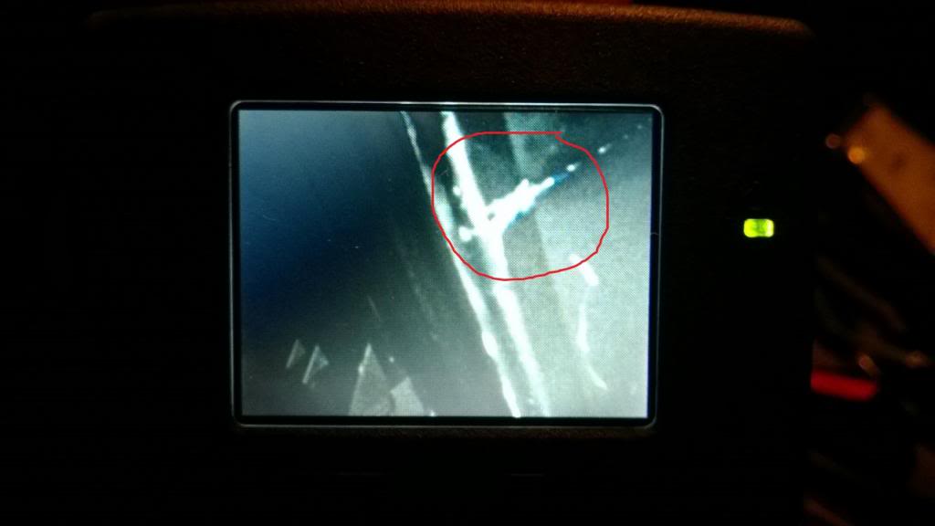

....I wiggled it up between the lower trim and carpet, and I can see what I believe to be the lower part of the matrix housing. It looks wet, and has blue residue:
.....not a very clear picture but I've circled the blue residue.
I suppose I can be thankful that on a right hand drive 406 changing the matrix doesn't require the whole dash to come out and is reasonably straight forward from what I gather.

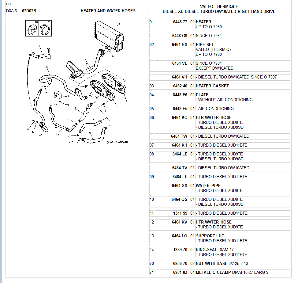

Seals (item 3) are new yes ?
Slightly large pic but easier than trying to split it and if its small you cannot see enough detail. :oops:
