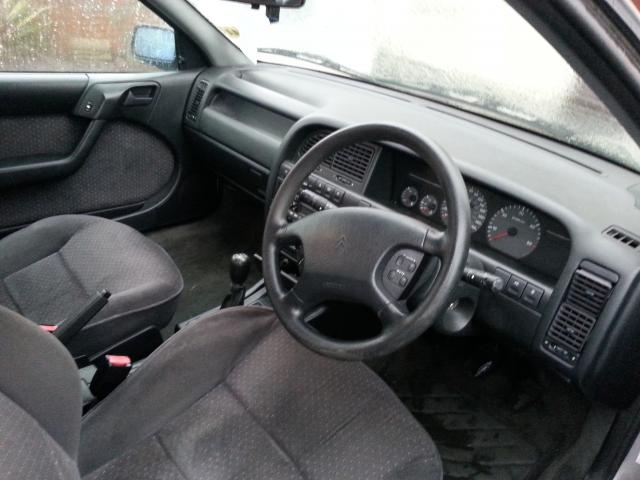

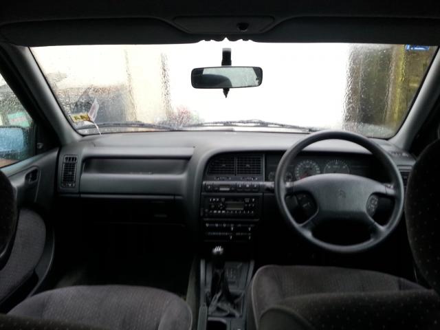

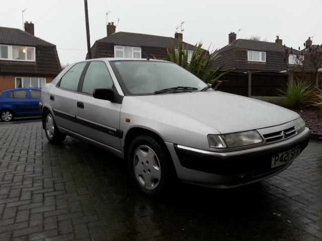

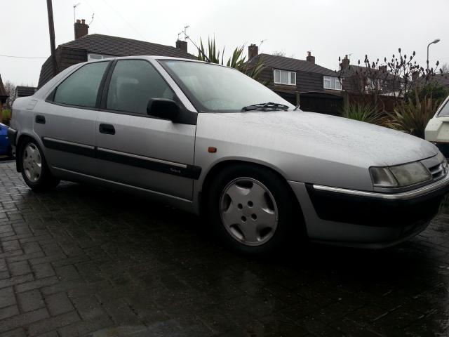

Hi everyone, I've recently bought my first Citroen and I love it! I've been driving it for about a week now and I've never driven anything like it. Here are a few pics of it, shes a bit rough around the edges but I haven't paid mint money for it
The only problem I've got with it is that the heater motor has been wired up to a separate switch as the control doesn't work, also the rear demister doesn't work along with the aircon. Are all these problems related? Any help/advice would be greatly appreciated.

WELCOME to Xantia owner ship, you have a nice Late model there, SX with standard Alloys that came on SX on the Series one Run Out.
