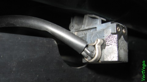

Hi MortyDK, I had a S2 Xantia like yours and the windshield washer jets were electric heated. I think you also mention the metal ring around the 2 wires on the side of the nozzle. The ebay part link you sent would fit Xantia but they don't have heater in it.
VertVega
- Posts: 1178
- Joined: 01 Nov 2008, 19:39
- x 13
Re: Xantia windshield washer jet, part?
I found this pic from my archive
