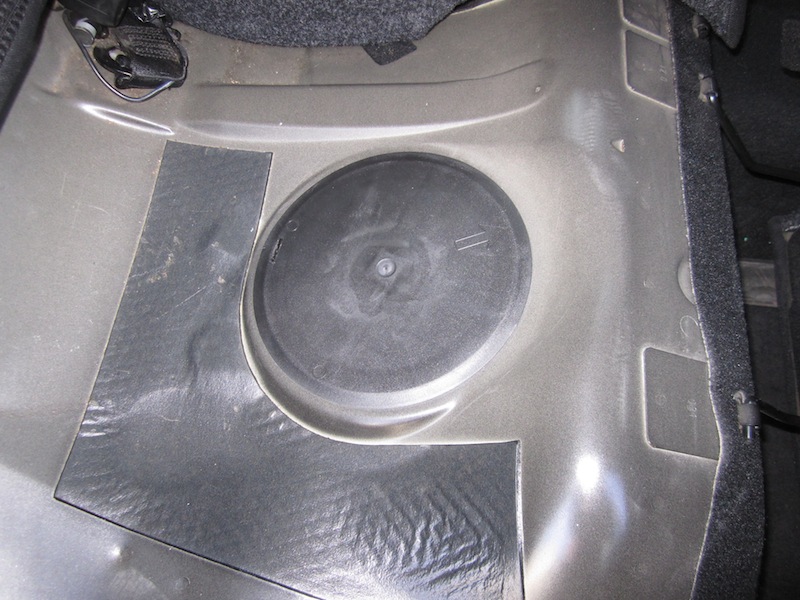

To add to the conversation, I have a petrol C4, and here is what you find beneath the rear seat cushion.
A black round cover,

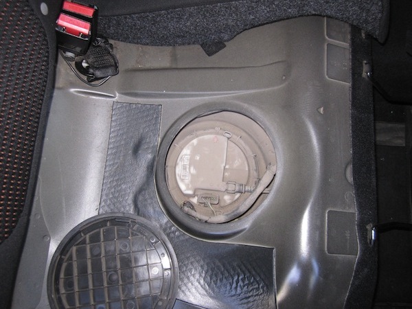

Beneath the cover, is this, (it is a fuel pump, right?)
A closer look:
So the question still remains: Where is the fuel filter, on a petrol 1.4 C4 ?
Does anyone knows?

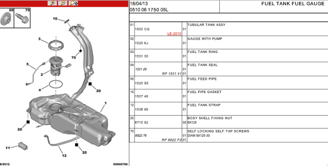

At Citroen service website, it shows the filter in the diagram, but, there is no OEM code in the right panel (see image, part 11).
Anyway, I think the filter is inside the fuel tank and is not subject to regular maintenance.
