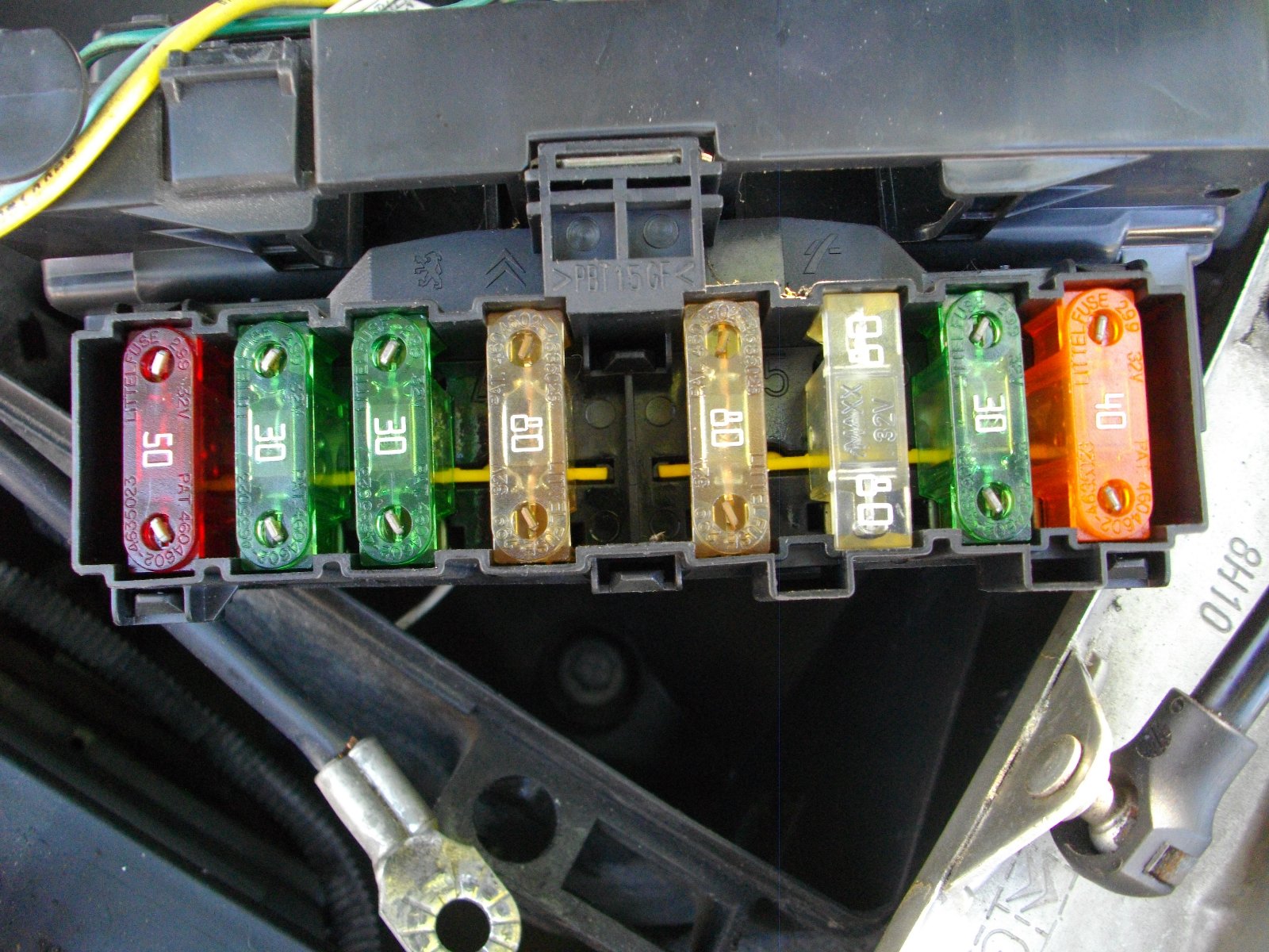

Have you checked the Max-fuse under the underbonnet fusebox?

Mine don't work either and I have fitted a maxi fuse.

Are the two fuses present in the glovebox fusebox too. Four all told, one for each seat heater and one for the motors in each seat.

All fuses present and correct in glovebox. Haven't checked Maxi fuse though. Seat motors work fine. Which Maxi fuse should I be checking?

IIRC it is the centre one, IIRC it is 80A. Will check that. It is intact if the motors work though.
Ed:
One of the two 80A fuses. I am sure I fitted only one, the other being present, I bought two, one as a spare in case I destroyed it while fitting the seats.
May be worth checking that both are intact in that case.
Ed:

I have just had mine out - bought a new 40A fuse as I was under the impression that this was the value for the radiator fan.
I should have one here as I bought a spare when fitting the electric seats but couldn't find it, wanted one on hand before disconnecting the battery.
I have no idea which does what unfortunately.
