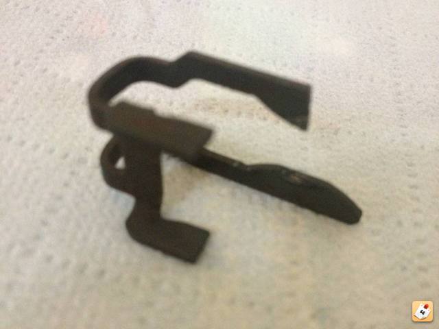

The clip was indeed the original. As photo, the metal clip actually failed and broke a bit off the black clip. This has not been replaced with the cream clip and new metal clip.
Question 4:
What causes the clip to fail in general?
Question 4:

If it has a Black Clip then simply the clip design as theres NOT enough plastic in its construction.
If its a WHITE clip that’s failed then that can be signs of poor nylon bushes in the gearbox PLUS a heavy clutch indicating needing replacement soon.

Paul - black clip but this does not fully explain why it failed. Black clip, though not enough plastic, has served for nearly 19 years. Something causes it to go. There must be another reason.

Its a sign the clutch is getting TOO heavey then Roger...
DO NOT adjust the pedal up too far, because if its too high and the travel ends at the gearbox end before the pedal gets to the floor you can potentially pull the cable out the clip AGAIN!!!!
Its a sign then that the nylon bushes and clutch will need replacement soon!

Well if the clutch is fine, then it IS the fact it was the original Clip! Compare them both, you will see there is hardley ANY plastic in the middle where the metal clip goes in...
Ive also had a few metal retainers break, but I think this is down to brittleness, why they should no idea. But IF I was you Roger, I wouldnt just fit the new Metal retainer, I would be changing the black clip too... But that IS GREAT FUN to do!
