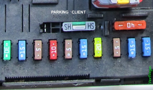

Have you been messing about with any fuses recently before the problem started ? If the shunt fuse has been moved to the 'park' position & not in the 'client' position it can do this, it's to save the battery going flat if the car is sitting in a compound for months when it is new.

Aha, soundes like possible cause. Where is this shunt fuse located?

In the interior fuse box right in the middle, it has SH marked on it & can be fitted in 2 different positions park & client. It should be fitted in the client position.

Axa, I found this pic in my "archive" taken during sunny summer days
I thought this pic might enlighten a bit in the dark Nordic sky. LHD car like yours
wheeler, this was an interesting information, thanks. If I have to leave the car for long time, like 2-3 weeks then would it be wise to change the fuse into the "PARKING" position? Could it be used for that purpose?

Thanx allot for all advice! Vega, you where spot on! I had accidentally moved that shunt fuse to the parking position. Problem solved.
