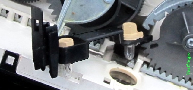

Hi. my 1996 Xantia TD, Iam trying to replace the bulbs that illuminate the heater control panel . I think there are two. Iam having trouble locating them ! is it possible to remove it? ( the heater control ) thanks in advance Terry.

There was recently this thread about a similar case in a Xantia II model.
I'm sure that will help you. I've sent this pic there where the 2 bulbs are seen.
Bulb type is (in MK2) R509TMBK Dashboard Bulbs 12V 1.2W
