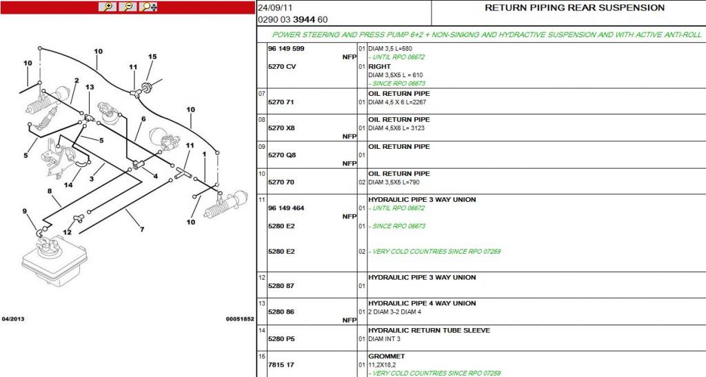

Right, I finally got around to doing this today, had it up on the ramps and i'm slightly confused now.
The leak is coming from a junction piece which sits above a sphere at the drivers side rear, is it the junction piece that causes the leak or the pipes going into it usually? One of the pipes wasn't pushed into the junction fully so I thought that was the culprit at first however after pushing that home with some very long needle nosed pliers the leak continued. It is so difficult to see and get to that i can't make out whether its a pipe or junction at fault.
I've looked on citroen service and that only added to my confusion, I thought that it was a 3-way junction which was y-shaped, but looking at service the junction that looks to be in the correct position is 4-way, due to the awkward location i may have just missed the other pipe going in. Can anyone shed any light on this please?
Also if it is the 4 way junction at fault, does anyone have one? It's marked as no further production on service.

Re: Activa LHM Leak
Maybe the junction piece itself is leaking...

Leak solved! It was the 4 way junction to blame, one of the pipes had popped out of the top of it, hadn't seen it due to the lack of access. Anyway I managed to get it back into the junction without taking anything off which i'm amazed by, luckily i have fairly small hands and a lot of patience! One thing is niggling though, why would the pipe have come off in the first place? Can pressure build in these pipes and blow them off the junctions? Or has it just worked its way loose over time?
