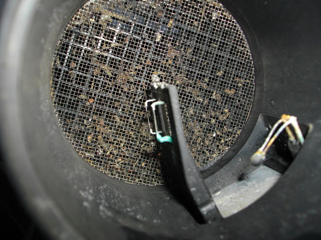

This was my MAF when it became unusable. The bead on the right is the temperature sensor.
Have you a picture of the Denso sensor - I think that this is the MAP sensor but my car is away at the NEC currently so can't check that.
When my MAF went down the diagnostics indicated a dud MAP sensor too. I was too stingy to buy one when I bought the MAF and it turned out to be a red herring, MAP is perfectly fine.
In your case it may not be of course.
