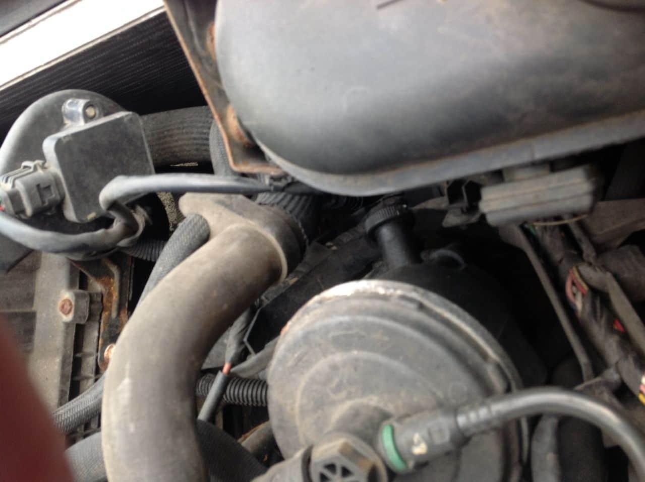

I think I found the leak, it looks like it's coming from the knurled plastic valve thing in the middle of the image. Is that on the fuel pump?
Steve

That's the fuel filter drain tap. You can get (I think) a new o-ring for it. Usually should be changed with the filter I think anyway, perhaps the last filter change they did not.
Just unscrews by hand (have a drain tray or large rag underneath) although if you leave the filter pipes on it should not leak too much.

191720 is the part number for the drain screw as far as I can tell. I could not get a picture of a 306 one although the 406 HDi shares the same part number so I guess its safe to say its the same.
If that does not cure it you'd be looking at a filter housing I guess. Easy to change.
Andy.
