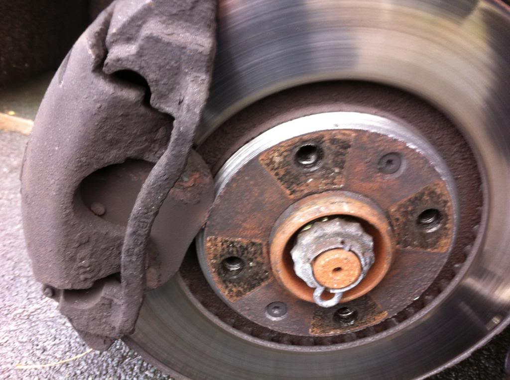

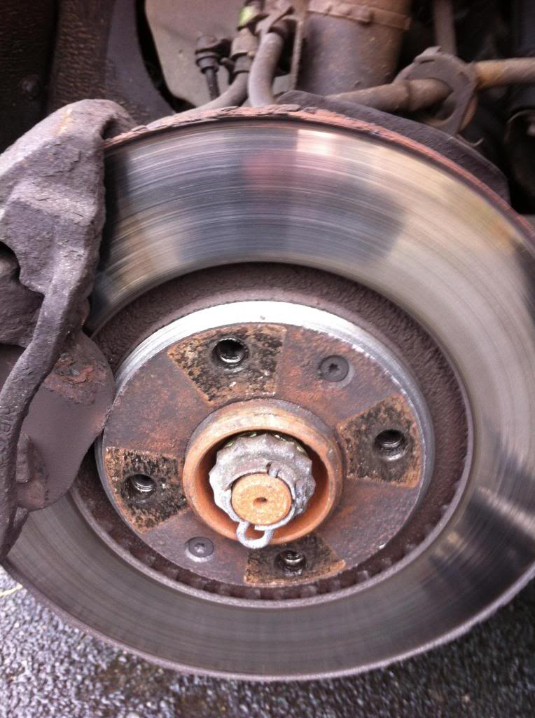

I recently had a problem with my nearside front brake making some rather horrible grinding noises. Took the wheel off to investigate and found that the outside pad (although not worn down to minimum thickness) had moved in towards the disc sufficiently to drop out of the calliper and get jammed between the calliper yoke and the disc. While the brake performance was surprisingly unaffected; the horrible noise was the pad backing plate rubbing on the disc hub.
Now I know I'm heavy on the brakes and these discs have been on for 120k odd miles but my conclusion that the disc had worn enough for the pad to do what it had rather shocked me. I got the micrometer out and found that the disc was around 18mm thick, i.e. had worn down (as I thought) 8mm which I couldn't believe.

Holy heck those are the wrong pads.

Xac
Why do you say wrong pads?
Posts: 14308
x 3296
Re: Xantia Front Brake Disc Specs
They are rubbing against the central part of the disc. Pads should only contact the main part of the disk (nowhere else), and CERTAINLY NOT the raised point that bolts onto the hub. I wonder what your fuel economy was like?!?

The picture is of where the pad ended up after it had become dislodged from the calliper.

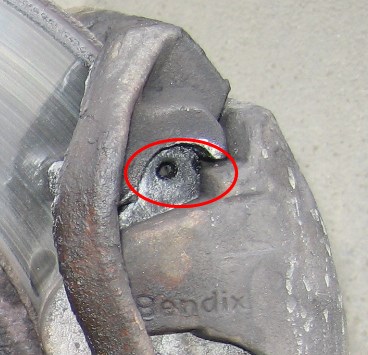

Here's a close up of Xantia front brake pad top part. In yours top part is dislocated.
The red marked part should be as in the pic and the same in the lower part of the brake pad.
It's either wrong pad (a short one) or the part is broken (?) which I never heard so far.

Yes the pad has become dislocated. The pads were coming to the end of their service life. I believe that because the discs were down to 18mm, as opposed to the minimum 24mm I think is the minimum spec for the car, the pad could move close enough to the disc to drop out of the calliper and end up where it did. The root of this was that I had been supplied with 22mm discs rather than 26mm even though they were the correct diameter.

rory_perrett wrote:Xac
The pads should fit snug inside the calliper, as Vert's photo shows, with no way to slide down towards the hub like the ones in your photos have.
