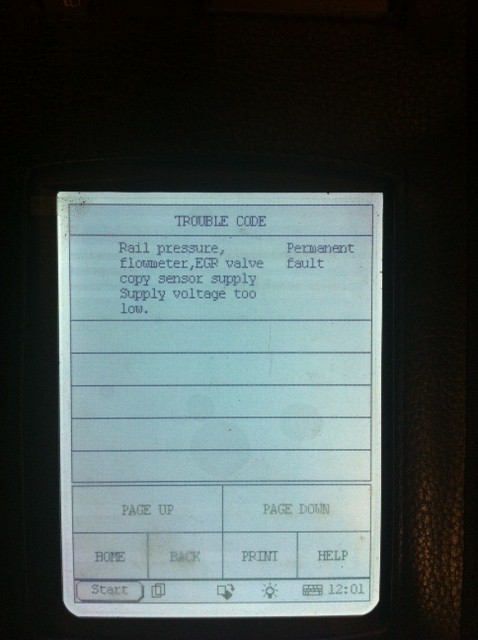

On my way to work this morning in my 09 van 30k which had its gearbox repaired only last month for it to make a bleeping sound and a warning of anti pollution pop up on the center console and it die....Pulled over and it restarted but had that yellow engine light on so I turned it off and phoned a mechanic he said come down we will code read it, ok went to start it just turning over as if their was no fuel so I phoned RAC to be put on hold and whilst waiting I tried it and it fired up so i went to garage under my own steam.
Anyway they put it on a reader and got this
Now he cleared fault and disconnected battery etc and recconected and started only for it cut out after a minute of running and it came up with same codes,
He cleaned earths on the van checked loads of connections near the rear of engine and reset and again it stalled, when he got it running again he then ran through some live testing on the reader etc and he said it all was reading fine.
Ah well it then would not start when switched off, so he removed them units think its bsi and maybe ecu and on the unit in that tin cage some connections did look furry so he cleaned them up. Now all seems fine after another reset and i've done 50 miles since stopping and starting and well im hoping thats the end of it but knowing my luck the thing will rear its head again...Billy no luck me :)
Anyway i've looked around here and other places and some say faulty bad connections to ecu....the ecu...Egr valve and whilst the garage i've been to is an old school mate he is a mechanic not an auto electrician and he now suggests that will probably be the next move it it reapears because of so many faults...so any input would be welcome

The egr valve & rail pressure wiring run through the same wiring conduit at the back of the engine. I have had problems with the rather thin wires wearing through on the plastic conduit. May be worth stripping some of the conduit off, and tugging on the wires to see if they are worn through. Usually at the most vulnerable near hot bits or on bends

EGR failed open on my C5 one day after I stopped and car would not start again. Had conked out a few days earlier after initially starting which I now know was the first sign.
Like you it looked like no fuel- would crank and almost start.
If you got it connected to Diagbox it would most likely pinpoint the fault - did on mine.
You can use very thin metal to blank the egr at one of the joints to see if it will start ( with egr open its choking itself).

Well my van is back the auto electrician had a feeling that ECU may be at fault last tuesday and he was scratching his head and huffing and puffing £800 for an ecu+programming blah blah blah then friday I had a call saying they had pinned it down to the Rail pressure sensor £380 later im ready to go earn a living again thank the lord all this hassle for a £70 part and to honest if my mate would have had more electrical experiance in fault finding I could have done that sensor my self but it was sending the ECU in a right hissy fit as you can see from the lauch reading above and the readings got worse the more we forced it to start.
