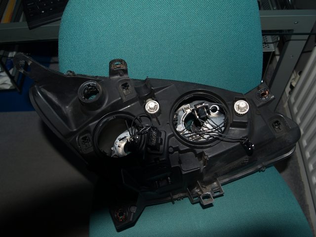

Mike, there are two adjusters on the back on the Halogen units, only one on the HID units. - looks as though the vertical one is replaced by the self-levelling motor.
Just waiting for the photo to upload, thousands on the camera, can take a while.

The two white thingies.

Thanks Steve, I'll have a fiddle later on when I get a lunch break.. hopefully I can make my journey home a little less interesting than the journey here:-)
