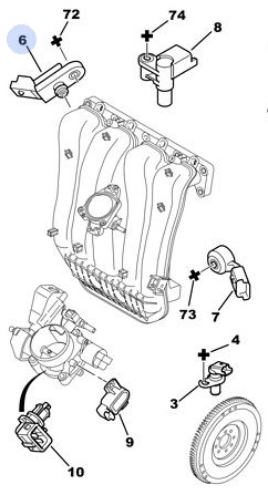

can you tell me were is the map sensor? picture will be very helpfull if it is not so hard,

I'm not 100% sure if it's caused by MAP sensor because it should also show symptoms while driving at constant speed.7kongo7 wrote:t its apear only in the my first kick gas, and after that ther is no sign to that.
Anyway I checked your car's engine type and it's the number 6 in the pic.
Your car is MK1 type and it seems that earlier model petrol cars still have fuel filter. You can check it under the car, in front of the RIGHT rear wheel. Fuel filter is a cylindrical tube like metal or plastic case with fuel entry and exit pipes.
