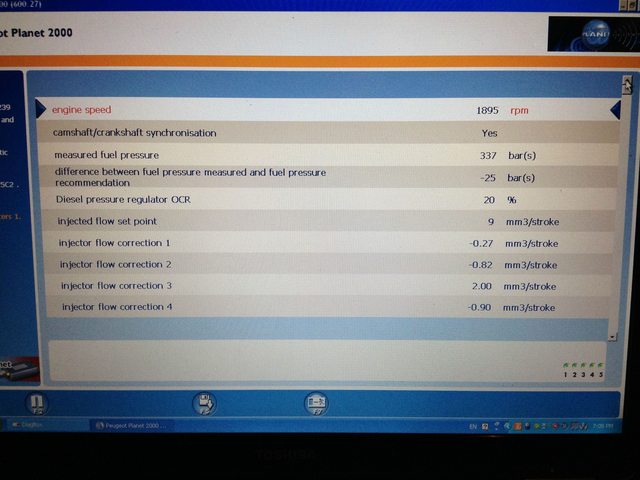

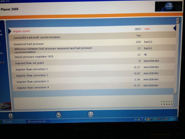

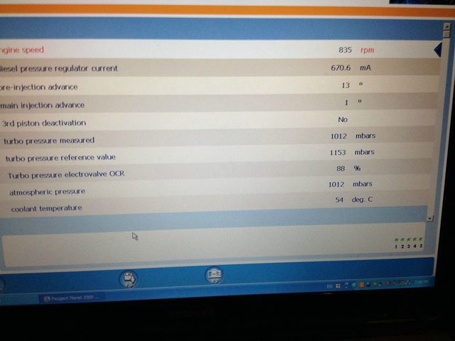

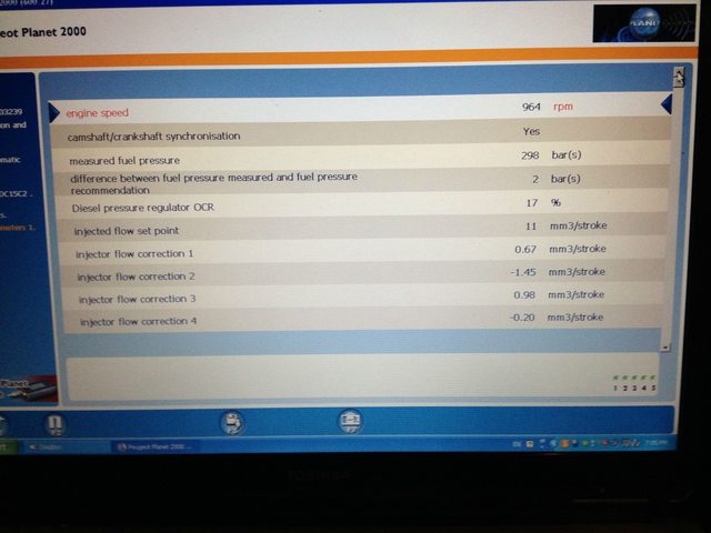

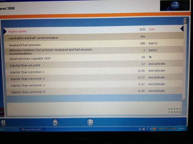

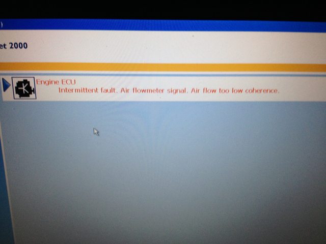

Hi again, Thanks for your input Gibbo and Peter, i went and plugged the pp2000 earlier this evening and came back with some numbers. pictured below are parameter measurements at different revs.
i also had the error code pictured there aswell.
Peter its not hunting as such just on idle it had what feels more like a slight misfire, causing the car to judder a little. The needle is unsteady on first startup
Cheers again

You will need someone who has a Lexia that works to interpret those figures for you.

Everything looks nominal on those screen shots.
I'm assuming the MAF error is because you unplugged it to squirt in the EGR cleaner?

hah yes, that would have caused it!
