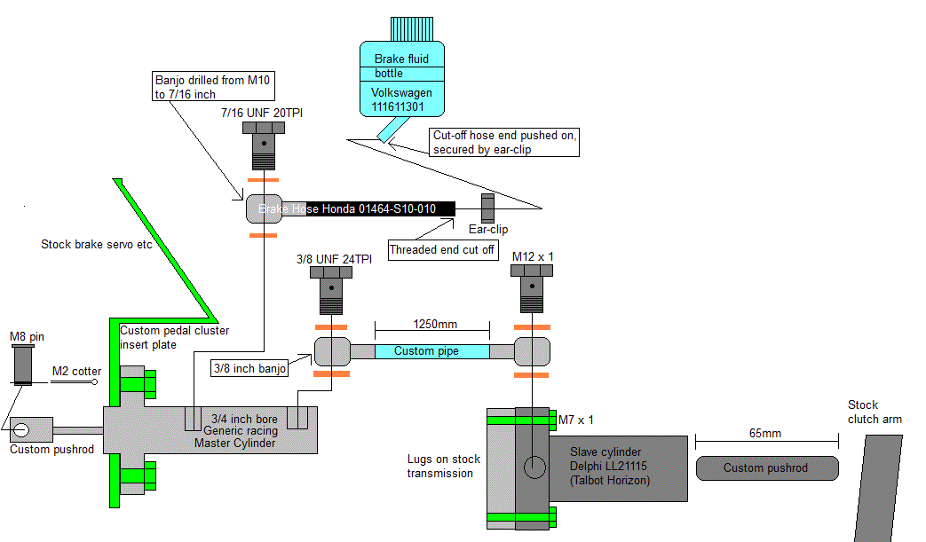

So, this is a diagram of what the whole mess looks like in the end after some more tweaking.
So far seems to work surprisingly well!
The custom pressure hose is a teflon/stainless steel braid hose and came from a company that makes hoses for racing stuff and such, as did the generic master cylinder (as found in adjustable-bias brake systems etc). The teflon/stainless hose is probably way over-kill, and just a nylon hose would be fine, however I couldn't find any companies that make nylon clutch lines like old cars used to have, so just used a typical modern style teflon/stainless hose instead.
In the original prototype, just to see if it would work, the clutch line from the master to the slave was made of various sections of copper brake pipe (both 4.76 and 6mm) connected with various assortments of fittings (including a flexi hose from something really random like the stick version of a Blazer or something) to make it all fit together, however once I made sure the setup worked properly, I just ordered a custom pipe instead to replace all that.
The feed hose is actually a Honda HRV (or CRV?) front brake hose. In the prototype stage it was a piece of copped pipe with a brake-line style flare and pipe end, connected to a piece of brake-fluid-proof silicone hose, connected to the Volkswagen fluid bottle, however this caused some clearance problems, and since the Volkswagen fluid bottle has a really small outlet, which a cut brake hose fits on nicely, and the Honda brake hose already has a banjo fitting, we decided to just drill the banjo for 7/16 inch (which is almost exactly M11) and then just cut the hose to length and connect it directly to the fluid bottle with a ear-style crush-clip just in case.
So, there, I finally achieved it, yay!
