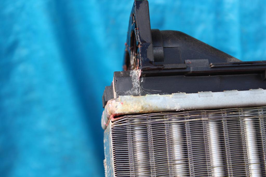

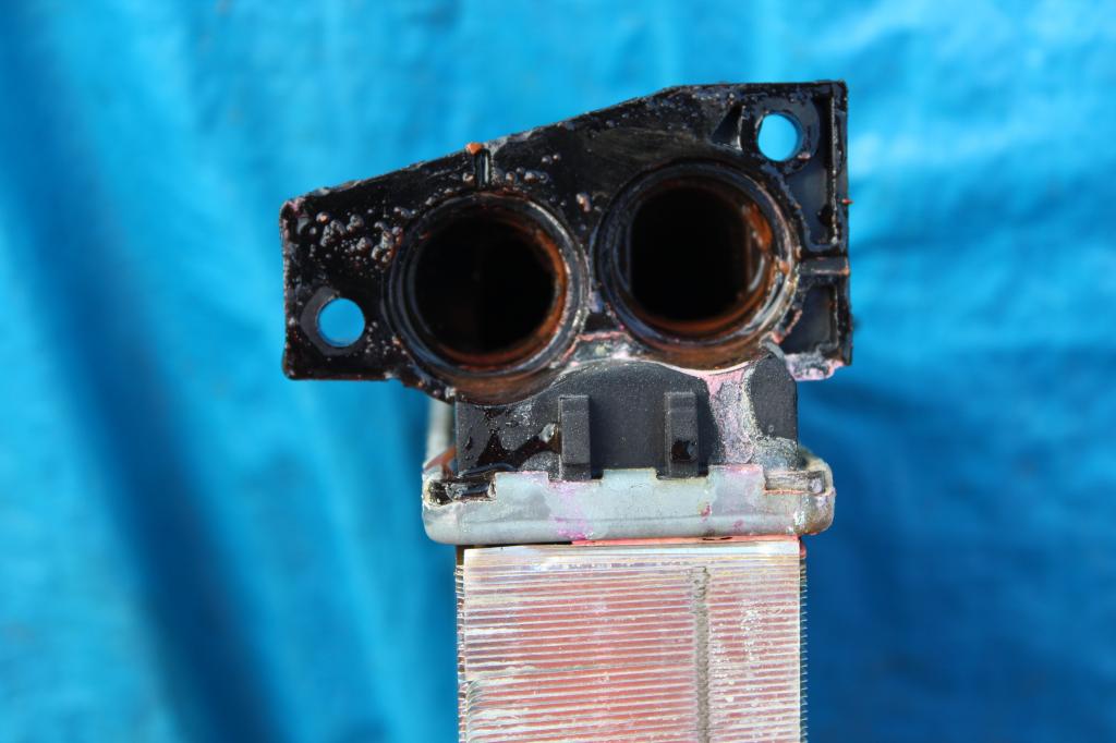

The heater matrix had been leaking from various places as can be seen in this pictures

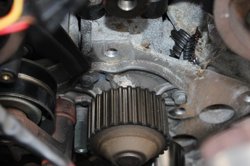

Also there was corrosion damage on the water pump

The heater matrix was gone in the usual place Steve. I reckon the matrix itself is OK and if just the O rings in the (inaccessible) joint were replaced they'd be OK again.

Wonderful :roll: could have saved myself 70quid and just bought the rings...... :rofl2:

Id never reuse a matrix after taking it out.. did that once. We rescused an almost new matrix from one car went to the trouble of fitting it to another and two days later it went pop... so we had to fit another.. so steve no it was 70 quid well spent indeed!
