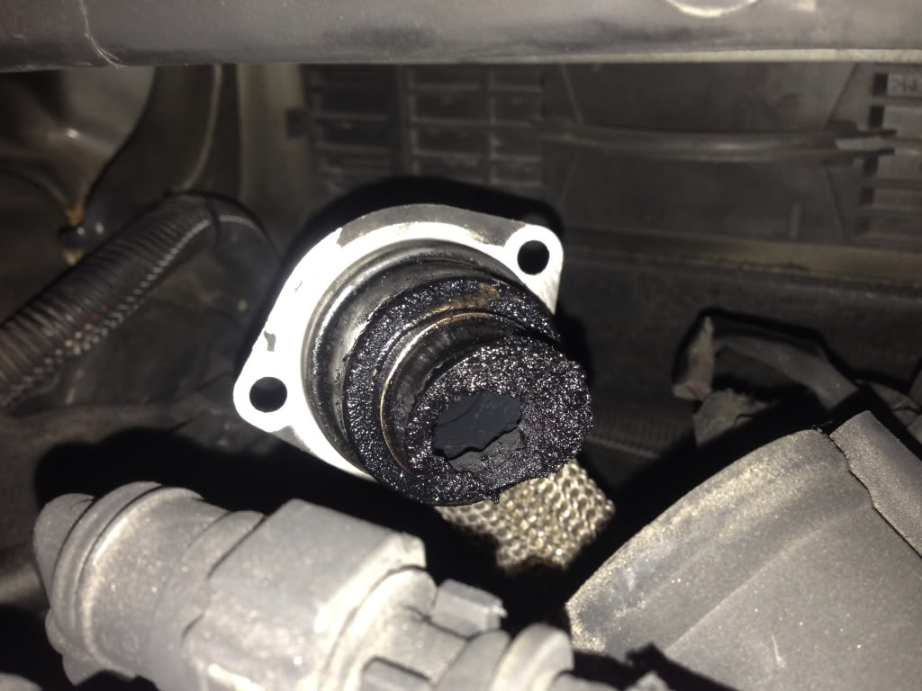

The "low thumping" sound is now cured. I removed the inletmanifold and found it filled with a layer of goey carbon contamination. After cleaning the manifold, and as good and far down in the inlets as possible I started up and found out that one inletvalve was not closing all the time on idle.
I solved it by spraying some diesel, wd40, bbq cleaner down the inlets. Before a final spray with bike chain lube I used a gasburner to burn out contaminations while the engine was running. Now all valves are sealing again.
I have also cleaned out the DPF and catalytic filter with highpressure washer. And also blanked of the main cause, the ERG valve. :@

Good call, they tend to look like this :(
