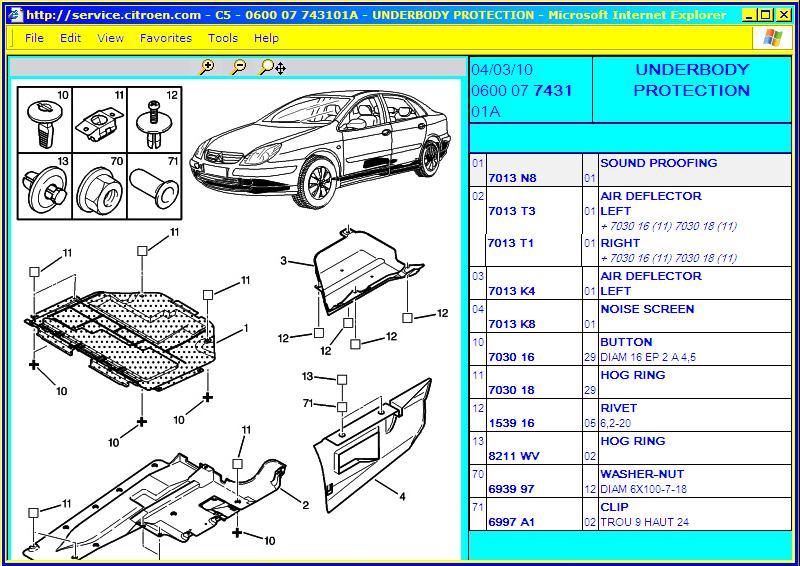

Ok having a look on service citroen i can get the hog rings as they are called bu it doesn't list the bolts for putting through them.
Its a Mk1 C5 HDi90 Hatch.
here appear to be some bolts type items but they have a flat side so are the turn 90' type of thing to lock them in place and not sure they are right for the hog rings which are part 7030 18
Any help would be appreciated as i took it off for the oil service the other night and haven't put it back on as i want new clips on to secure it as the arch liners are flapping about when i go past 70 which isn't a biggy for me as its no that often i do that but coasting downhill at that speed and having to slow down was annoying yesterday.

Item 10, part 7030 16, called 'button'.
They need pushing in straight and tight, without turning.
The 90 degree turn is to loosen them.

Cool thanks cloggz! I wasn't sure as I had always dealt with some kind of bolt in the past but will order some up and give them a whirl :)

Somehow, four of them are 6 mm bolts on my undertray, while the other four have the buttons in them. :?

That's what I found, well the remains of 2 bolts so will see how this goes as I got 20 hog rings for a few quid and will see if I can do the same with the clip things :)
