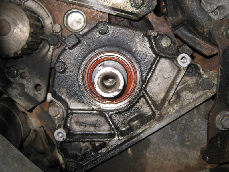

Finally the crank area looks like this: Image i.e somewhat, but not excessively, oily. Presumably that indicates a slow crankshaft seal leak? Or could itbe coming from somewhere else. Maybe that's 'normal' for 8 years of seepage and there is no point replacing it? I'm sure that seal was new on the engine replacement in 2005, but I guess it started leaking at some point. I can find that seal at GSF, but not AEP.
I note that the damper/crankshaft pulley has noticeable cracking in the rubber. How bad does ithave to get before I should buy a new one? At £112 for a new one I'm keen to conclude that I can ignore it. Do the two halves eventually shear and the drivebelt stops driving?

All fettled now. Finished 1am thur night (before Friday's rain). No problems swapping oil seal or reassembling. Come to start car and it doesn't catch :-(. Pumped up fuel primer, some hissing, then some dribbling. quite a lot of dribbling. Fuel hose on exit of IP split at the jubilee. Sigh - must have been disturbed by general activities. Plenty of pipe, so hacking an inch off, reattached (with proper fuel pipe clip this time), re-primed and everything works as expected. I wonder how long that's been nearly-split for...
Anyway, thanks for the advice.
I'll change the coolant tomorrow as that's due/overdue too. The new engine mount will have to wait till I find somewhere to do the pressing (or go shopping).
