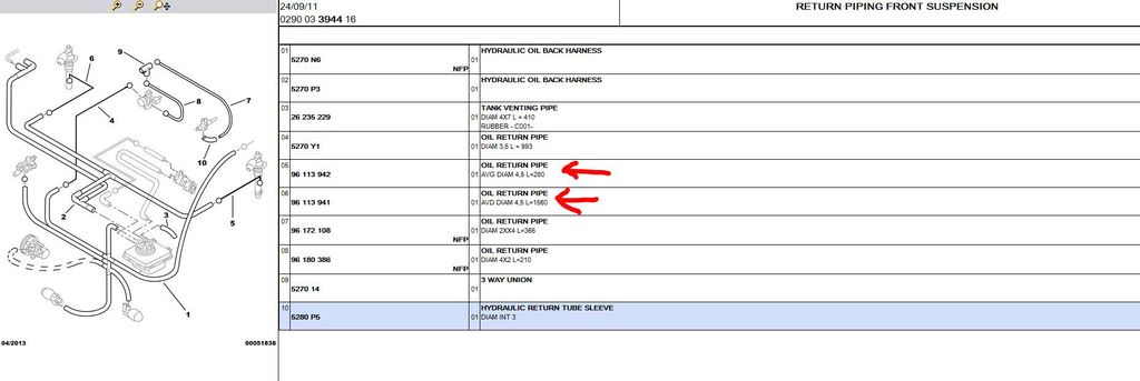

I repaired pipe with a plastic hose coupling of 5mm or 3/16" I think.
Two jubilee clips on either end.
One 60mm jubilee clip (from Screwfix), around the whole lot, but keeping the large metal plate that goes onto the back of the rubber pad to spread the load of the clip.
I agree that, that pipe is just going to keep splitting.
I went over to a car breakers and found the pipes on the similar aged cars are all perished as well - not surprisingly.
I called Citroen parts who quoted £25 (shorter one) for one side and £65 (longer one) for the other!
Maybe I'm looking at the wrong parts?
Thanks, Romie

firstly i think you are looking at the wrong parts/numbers,
No.'s 5 and 6 in your drawing are the metal pipes attached to the chassis rail's, which the leg pipes attach to,
you will find the leg pipes and there retaining clips on the drawing for front shockers/struts/cylinders,
part No, 's and price's as i posted above
95050399 LEAK BACK HOSE 12.88 GBP 15.46 GBP 15.46 GBP
96127591 ADJUST COLLAR 4.41 GBP 5.29 GBP 5.29 GBP
also in using a jubilee clip to hold the pipe block to the strut even retaining the metal plate, it is still possible to compress the block far to mich
Regards, malcolm.

Good morning Malcolm, thanks, yes I could see that I could put too much pressure when tightening the large jubilee :s Also the jubilee's thickness of the band was such that it wouldn't fit in the metal locking tabs on the large metal plate that goes on the back of the rubber seal.
I've purchased one of these special clip pliers now so will look into replacing jubilee back with the original clip :)
Many thanks for the info regarding the correct part numbers!
That would have def been an annoying mistake :/
Cheers!! romie

Hey, I found the parts that you are referring to under suspension/front springs..
Ugh, many thanks again for pointing me in the right direction!
I don't suppose you happen to know but it doesn't look like I've got the same rubber tube set-up on the rear suspension does it?
(just trying to pre-empt any leaks at that end!)
Thanks, romie

no not the same set up on the rears, they just have two plastic pipes plugged straight into the rear cylinder boot/gaiter,
