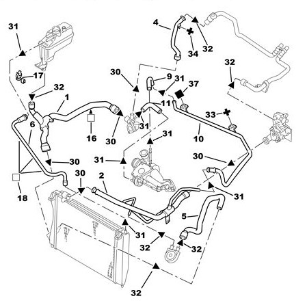

I'm not sure if this is same as your car but here's a MK1 cooling system. I hope it helps.
XANTIA 5 DOOR SALOON 2.0 i 16v 135
