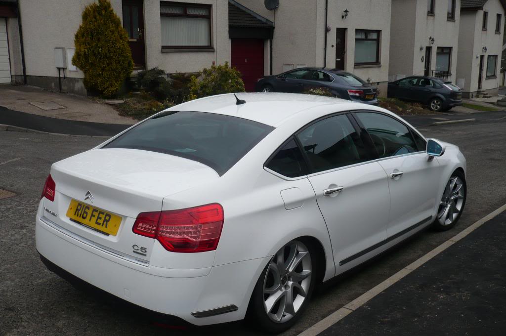

Sharks fin, on the roof.?

nothing on mine which is why I am wondering if it's built into the rear screen or possibly behind the rear view mirror?

Sound like a result anyway. I have never seen a C5 X7 saloon without a sharks fin on the roof. Maybe some owners will know different.
Maybe your car was a Friday afternoon build and they forgot the aerials!
Very strange to have a saloon without a visible aerial of some sort.
