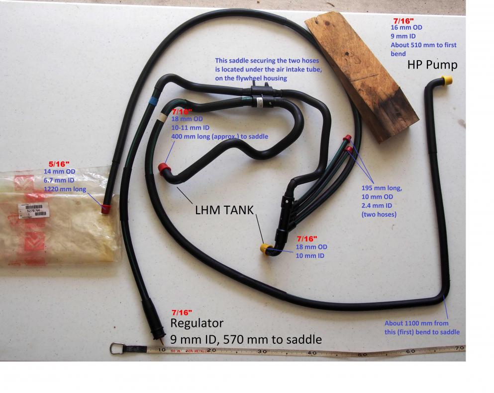

Now it seem that rubber pipes decided they won't cooperate with the hydraulic system and are failing one after another. It's jolly nice when you get stranded on the side of the road with a green puddle under the car. Looks like you just slaughtered a "Predator". Lost 4L of LHM in the past month and will be bankrupt it that continues...
I decided to change all of the return rubber pipes in the system. Now which pipes do I choose? Searching through forum I found that it must be either silicone, for gasoline or hydraulic (like on bulldozer). Other question is how much heat resistant must the pipes be? Is 100°C enough or should it be 200°C? Maybe any other suggestions for which pipe to use...
Does anybody maybe have a detailed sketch of the rubber pipes with diameters?

Re: Xantia stuck in "LEAK" mode
Is there any difference between this octopus (on the picture non-hydractive) and an activa or hydractiva?
I see that it is missing one return line from the electrovalve (should be T-joined on the regulator return pipe)... It has also different diametres from the pump to the LHM tank (mine is 10mm pump and 12,5mm LHM tank). Others are right?
It would be really helpful to have s a sketch like this and making your own homemade octopus would be easy
