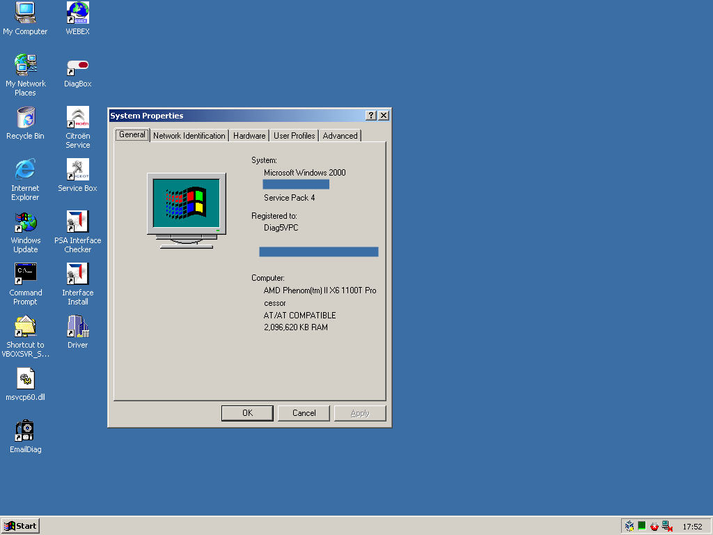

5.29 did install OK but I did not take it outside to the car, there were no problems noticed with the interface itself etc. I did the 'no update' edit anyway just to be safe.
This was on 2K with my 'dll' tweak.
My main one runs 6x something as that's what came with it and I just left it alone as it worked, although it does seem a bit flakey or slow sometimes but it works OK if you're patient. XP with 2GB and 1.6Ghz Atom though (but 4 cores)
