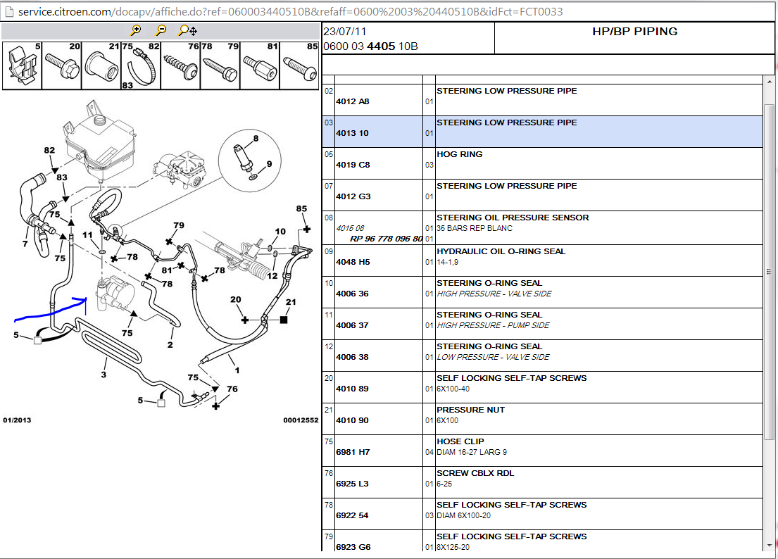

Ben82
- Posts: 1086
- Joined: 03 Dec 2012, 07:47
- x 7
Re: C5 V6 2002 - Power Steering got stiff.
Hope this provides some guidance at least, looks like you should be able to follow the piping from the reservoir for it (hopefully). I would imagine it's more a up on ramps job.
2004 Citroen C5 3L V6 Auto
Brit living in Sweden with an imported from Germany French Car!
robsterUK
- Posts: 16
- Joined: 29 Feb 2012, 17:03
Thanks to everybody for your help. Will let you know how I get on!
Rob
