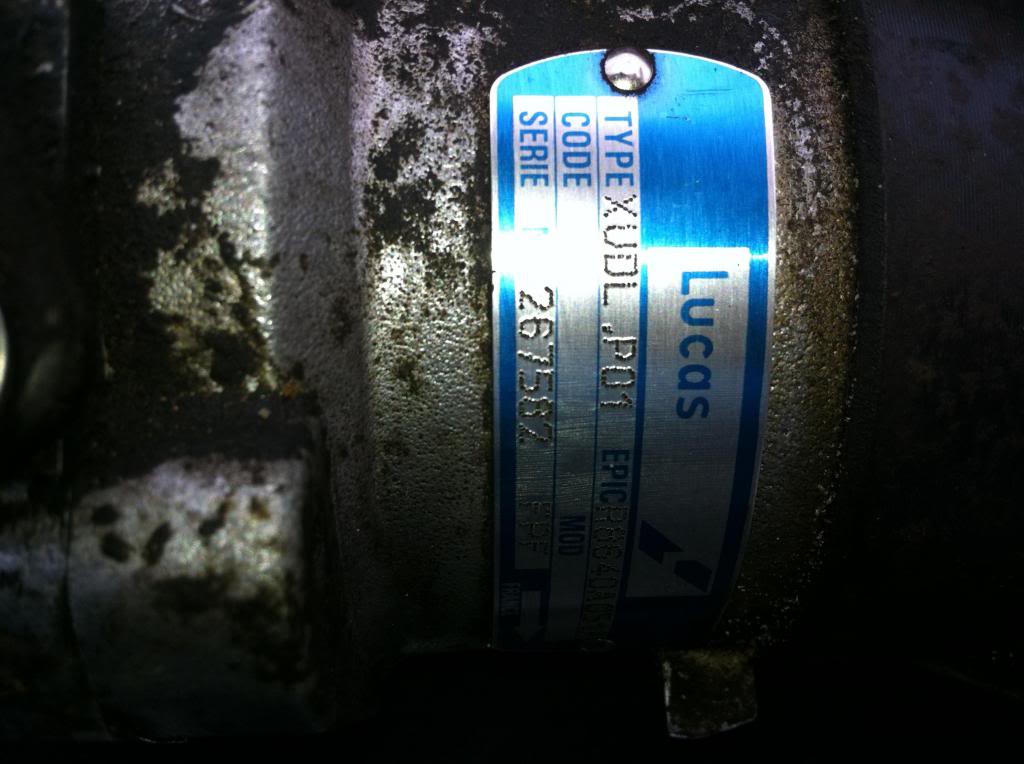

I don't know about the compatibility, but since it is for a 2.1 I guess it must be the same. Just to check, can you send me the type number on the plate under the body? And a pic would help to clarify the swapability issue too, if you have one.

Hi there Garry,
Just got it out of the shed and taken the following pics. Kids were using the bench/table, so taken on top of a wheelie bin (sorry)
Was working fine when it was removed from the car, but that was over two years ago. If you think its of any use to you, pm me with what you would be happy with, and I'll work out postage etc.
