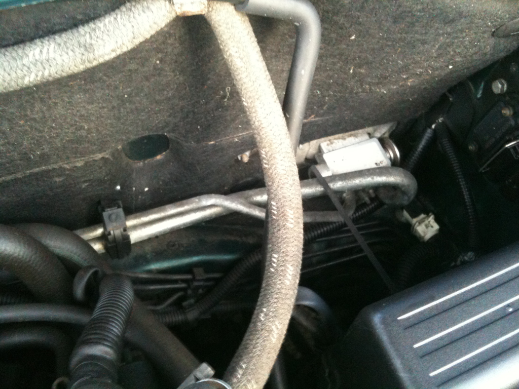

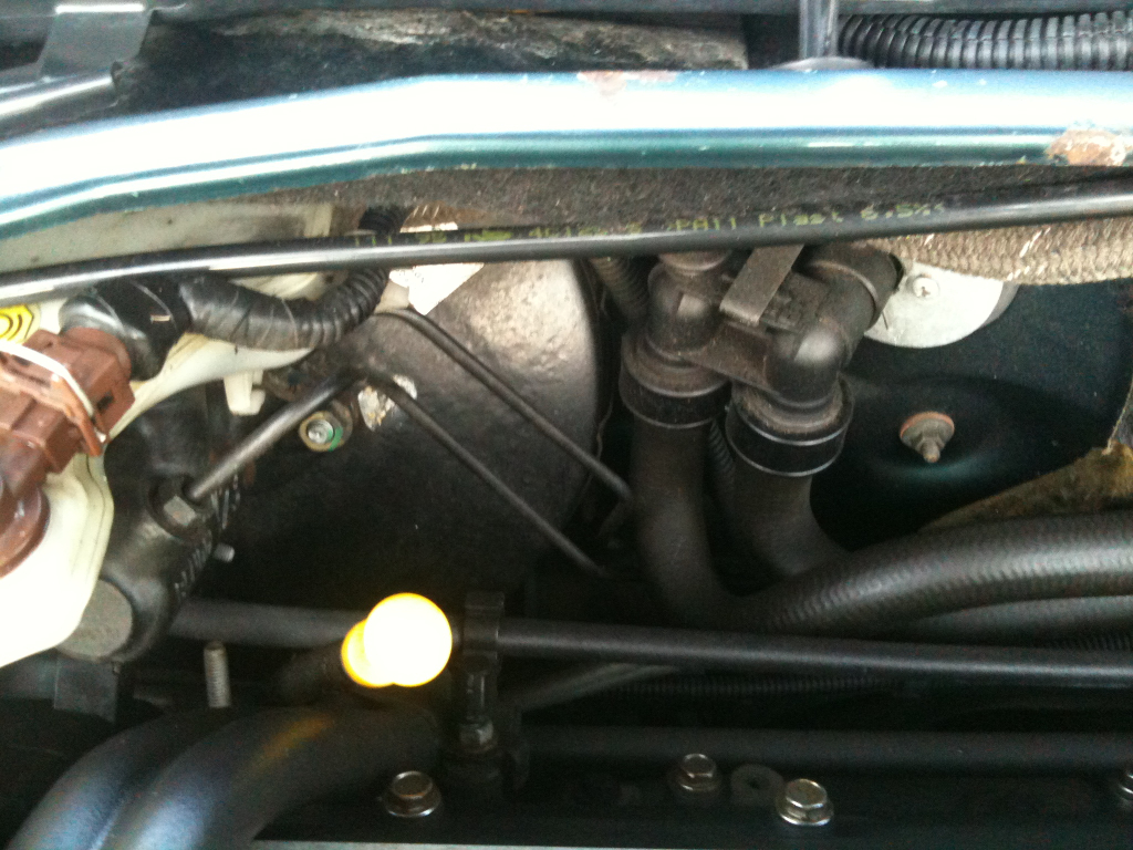

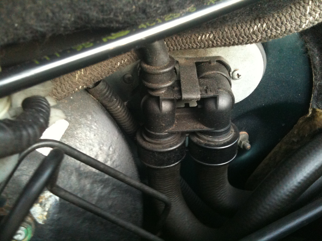

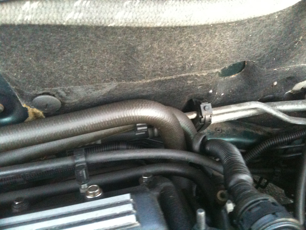

Heres a few pics , I hope there some help , mine is a 2.0 16valve so I'm not sure what the differences are . Also mine has aircon and due to that there's no glovebox .
This is the aircon side behind the glovebox
I know it's a long shot but have you thought of trying radweld , not ideal I know but it got me home when a BMW I had decided to drop all it's water , I hope the pics are of help .

Unfortunately, it doesn't have jubilee clips. It is identical to bxzx16v first photo but, from memory, the pipes go lower down the bulkhead rather then coming out, going down and then immediately back up as bxzx16v's does.
