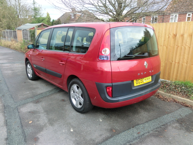

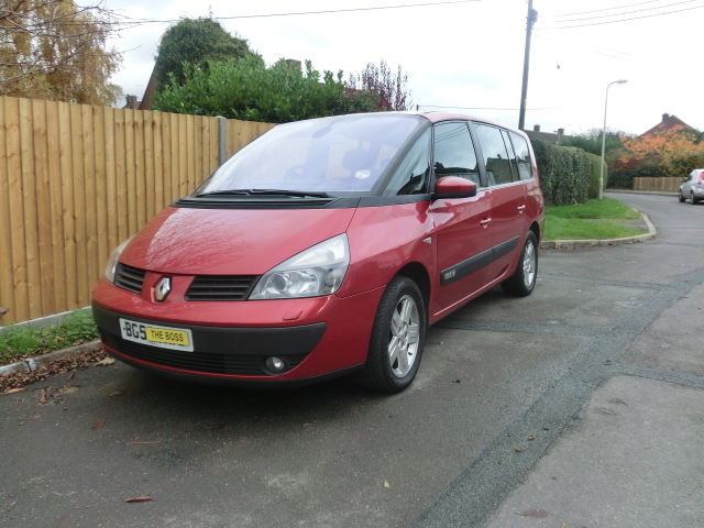

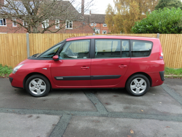

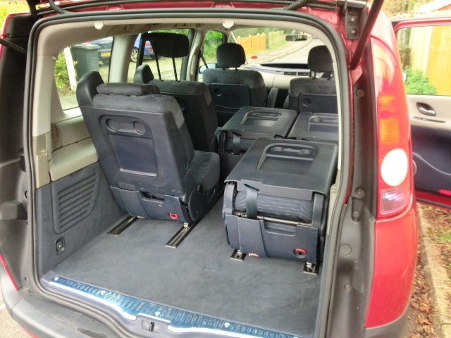

I have posted some pics on another forum that I am familiar with.
http://modelsteam.myfreeforum.org/sutra ... php#954302" onclick="window.open(this.href);return false;
It has some pics of the car on page 2

Lovely looking espace 8-) .
