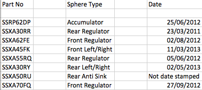

Here's the dates on the Xantia Spheres that I've got...
The other thing that doesn't make sense is the labelling of the spheres... According to what I've got here there's two rear regulators and a front regulator.
There's one sphere on the receipt that just says Sphere - Xan / XM Centre.
Problem is if I test them and put any LHM near them then AEP won't take them back...
David.
David.
