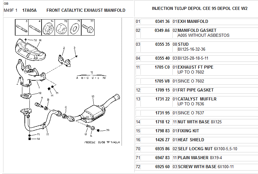

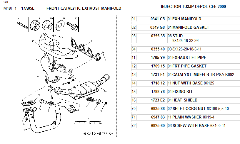

This is a Partner 1.4 although it should be the same as a Berlingo anyway they are the same car. Bad news seems to be the ring is part of the kit (item 15) though
as its item "C" you're after at a guess, the ring seal between the springs section.
I'm sure it *was* available separately at one time though but that may of been 106 / 206 / Saxo etc.
Choice of two although the later one I suspect is correct: Here are early and late pics:
Earlier Models:
Later Models:
Earlier Models:
Later Models:

yeah its C, kinda pissed as I beleived I was getting the gasket with the kit, as I don't know the size I'm struggling to find the correct 1.
