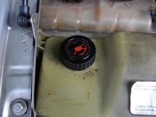

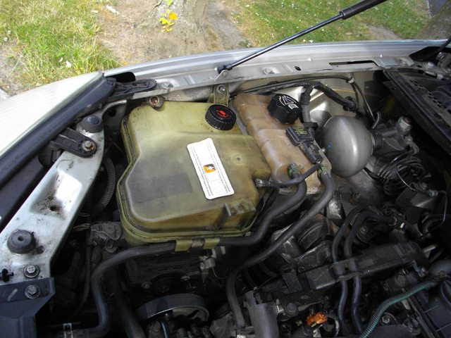

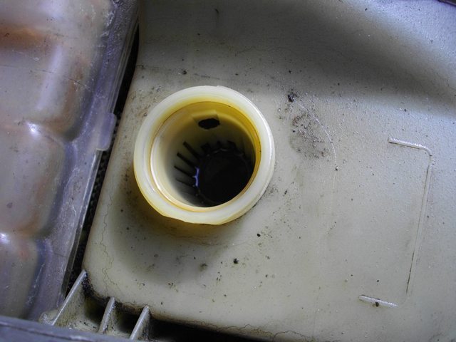

In the filler there should be a very coarse 'strainer' with two sets of cut outs.
Put the suspension on it's lowest setting and wait a minute.
the level should be at the top of the shortest set of cut outs for an Hydractive 3, at the top for an Hydractive 3+.
Fill with LDS to the correct level then raise the car to normal ride height, then refit the cap.
