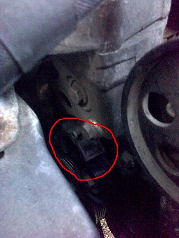

Hi, I recently bought a synergie so this is my first post in this forum, hopefully I won't have to make too many!
My drive belt came off a month ago although both the belt and the pulleys seemed fine, I put it back on and continued drivng. The drive belt came off again when I started the car on saturday morning. The belt was shredded, down to just 3 ribs wide, also the back of the belt has been scraped away. I checked the pulleys and it looks like the tensioner pulley has gone, I'm sure there were two black pulleys there before. The tension arm must have been rubbing against the back of the belt....
I'd like to try and fit this myself but i'm not sure exactly what part I should be looking for or if it's easy to do, the space is restricted and if the engine needs to come out of the car then I'll have to take it to a mechanic. I think this is the part I need http://www.expressfactors.com/Single-Part.aspx?GID=USD" onclick="window.open(this.href);return false;^GBT8206^3872^DITS-EN^TENP
Also, I'm not sure there isn't more to fitting the belt than pushing back the tensioner arm and slipping the belt on.......
Thanks for any help, Kev

hard to see what we are looking at in that picture
put it up on axle stands remove the wheel and the plastic wheelarch liner and its all nicely visible it can all come out without removing anything else
On the sprung tensioner there is the moving bit with a couple of small holes at the top fit the tensioner then using a long bar with a 15 mm socket push against spring till you can put a pin drill or allen key in the hole nearest the idler to lock it off. Fit the belt then release the pin and fit to second hole. Then using a 1/4" extension tighten the offset idler and lock the bolt. If you can remove the pin easily its at the proper tension.

as Sean says its hard to see the tensioner in you picy,
even though we dont need to as its a common fault,
usually the tensioner mounting/swing arm pivot bearing collapses which in turn cocks the pulley over at an angel,
the first thing i would do BEFORE STARTING THE ENGINE AGAIN , is check that non of the aux belt has got into the cam belt cover/area,
as the usual is shreds of belt wind there way behind the crank pulley and under the cam belt causing it to slip/jump teeth,
to do the above you will need to remove the cam belt covers, so it pays to fit new cam belt, tensioners and water pump whilst your in there,
part of this job requires removing the top engine mout so you can raise/lower the engine to gain access to all the relevant bits,
this is also required in the process of fitting a new automatic tensioner
if you send me the last 8 digits of you chassis/VIN No. i will get you the OE part No.'s to aim at you local factors/GSF???
