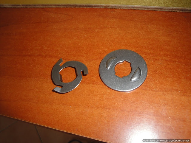

  • The new track rods came with these washer-type things. The old one didnt have anything similar.... should I put them on? where should I put them? Image

What about those washer-type things, do you know if i need to put them on and if so how and where?

the washer with spike is a locking washer for the inner track rod ball joint to the rack shaft,
i would use molybdenum/graphite grease for the rack

Ah thanks so a couple of questions:
1. The 2 previous track rod ball joints to the rack shaft didnt have a locking washer- should I use it anyway?
2. What about the other spacer? should i discard that?
