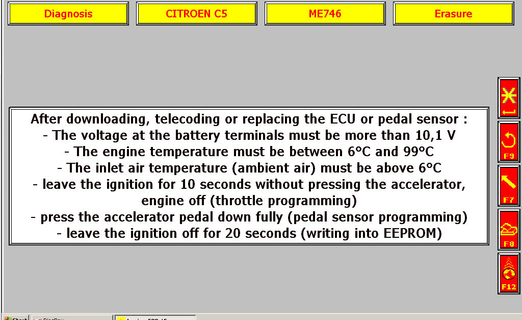

There is a TPS reset procedure (this is what lexia says it is for me whenever I go to clear the Injection ECU codes):
Also think there's quite a few places in the lexia that will give you "Pedal Position" or so (gearbox and injection ECUs on mine I believe at least), which will give you how much %age the pedal is pressed. You should be able to graph it on the C5, to see if it correlates with the cutting out, or looks incorrect.

Mike, I don't think you actually need a Lexia to program the pedal - just follow the procedure in the message that Ben posted! (The message from from the Lexia is just advice on how to program the pedal, the Lexia itself doesnt do it AFAIK) Worth a shot anyway before sending your Lexia away...Northern_Mike wrote:Ah, brilliant, thanks Ben. Now all I need to do is send the Lexia up to my brother...

Did all that.
Now it doesn't even start.
Ideas please, before I post the Lexia, or go up there myself.
