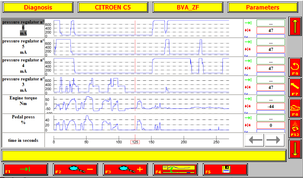

To say I'm disappointed with the parameter measurements in the Gearbox ECU would be an understatement! "Gear selection" would only report P,R,N,D (even in sequential, so was not useful in knowing the real gear)
I looked in the injection one which had the correct gear item, but engine torque was always "???Nm", so wasn't useful.
So I did options that I thought maybe useful, don't think they are too much.
I'm really not sure whether the pressure regulators are acting as they should.... don't think there's anything there that corresponds to when the groaning is occurring. (about 75s is when it occurred briefly)
The one thing that strikes me as odd, is the engine torque spending a lot of time BELOW 0... gets down to about -75Nm... The only thing I can think of why this would be correct, is when you are engine braking, and the figure is the difference between the torque that the gearbox has (from rolling along the road), and what the engine is providing).... however, this theory is blown out the water, by having ~-45Nm of torque when stopped!
On the engine performance side I thought I'd check the faults in the Injection whilst there (I've neglected them in the past as it's always been the "cat aging" one), this time the cat aging one wasn't to be seen, but was replaced with this:
Now this could have happened any time in the past 3-4months (last reset was in March). So I think it's highly unlikely that it's a frequent occurrence (along with I doubt it's related), however the rpm and engine speed seem around the right ballpark when the groan occurs.
Maybe the engine torque not being reported in the Injection one along with the negative torque figures maybe an indicator that the wrong torque is being reported to the gearbox?

Mandrake
Posts: 8692
Joined: 10 Apr 2005, 17:23
x 695
Re: Gearbox Grumble? (4HP20)
Unread post by Mandrake »
Hi Ben,
That dish sounds like it will do the job nicely :)
Yes you may need to remove the central wheel arch cover to see the side of the gearbox, my car has no cover there, I'm not sure if that's on all V6 Xantia's or whether mine is just missing!! :lol:
Your recording of flooring the throttle sounds absolutely fine to me, better than mine sounds.
What you're listening for is a stumble, splutter or unusual vibration when you first snap the throttle open before the revs start to climb. A stumble when snapping the throttle open is often a misfire under load, for example due to a weak spark.
Your second message I'll reply to tomorrow after I've had time to digest and think about it...
