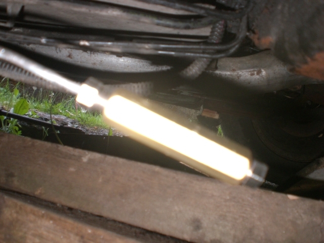

I recently had to replace a front-rear brake pipe.
It was very difficult tracing the pipe runs because the pipes ran over the top of the rear subframe. I spent couple of happy hours under the car drawing what I saw on bits of card and came up with this.
This is for the rear of a Xantia 1.9TD SX non hydractive
If you can do a similar thing for the front it does help

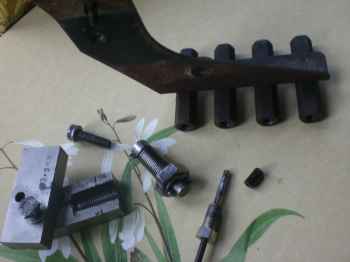

this is the "on-car" flare tool
regards Neil
