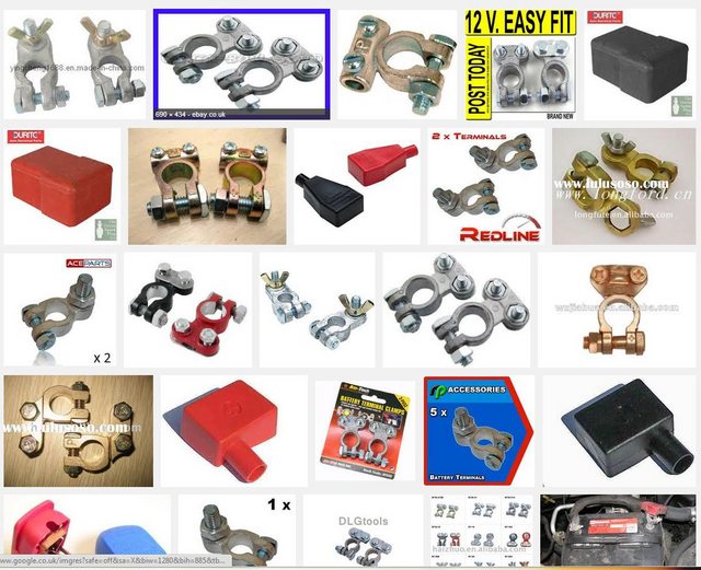

here you go Simon
http://tinyurl.com/kk8j7sq" onclick="window.open(this.href);return false;
the type i would go for are the end of the second row down, or at least that basic idea were the cable is clampt, rather than two screws going into/through the cable core,
or better still get a good second hand lead from the breakers yard
Regards, malcolm.

citronut wrote:here you go Simon
Malc, you might want to point out which one, as the end of the second row is dependent on screen resolution :)
I'll help you out a bit, here's a static image of the results, I'm guessing your screen is no larger than 2x this width, so should appear somewhere in this lot:
thanks Ben
the image is the second one in from the left on the third row,
Regards, malcolm.
