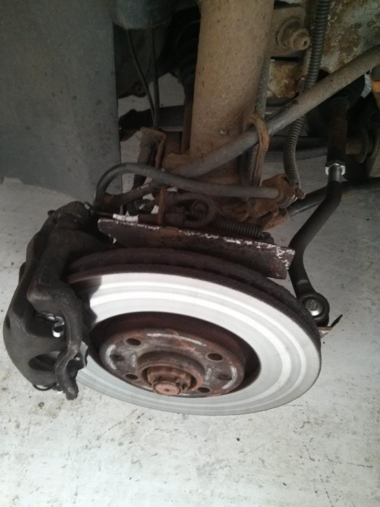

boristhespie
- Posts: 938
- Joined: 07 May 2009, 19:51
- x 4
Re: C5 conundrum and long journey ahead.
When the wheel was off. Very shiny and just noticed rings. It looked okay to me.
C'est pas possible!

boristhespie
- Posts: 938
- x 4
In garage now. Vibration came back today. Also felt like car was being pulled back. Sure it was like the breaks being on. Anyway handbrake it seems is possibly sticking and brake binding due to high temperature. Maybe that. They are soaking it in release oil over night. Last chance saloon. I'm off on long trip and he's off on long trip I just hope the car manages long trip. We'll see.

boristhespie
- Posts: 938
- x 4
Bl00dy car. Still same. The garagiste is off on holiday and this car is not right. Feels like I am driving while pressing slightly on the brakes.
C'est pas possible!
- Posts: 28690
- x 5674
Sounding like brakes binding due to stiff/seized handbrake mechanism.
boristhespie
- Posts: 938
- x 4
Yeah, thinking that. AnythIng I can do to try and mitigate given my garage is closed?
C'est pas possible!
