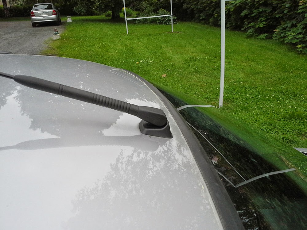

Here is my version of that repair

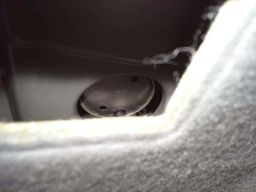

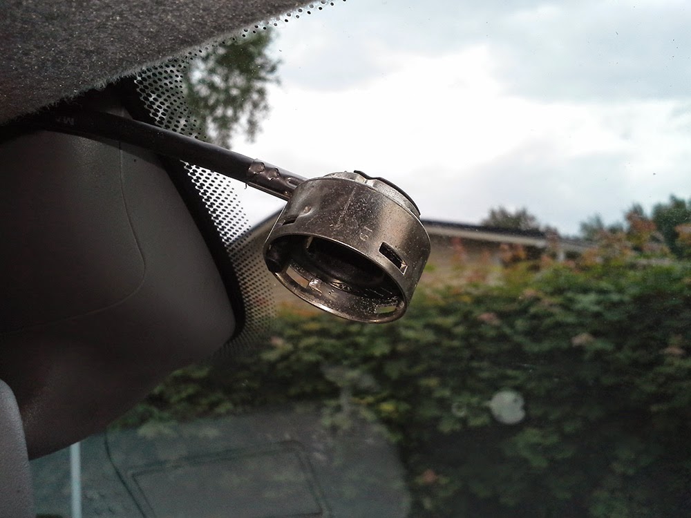

* once make that, the roof cover front part fell down and make enough space to work in. Take small ratchet with 8mm(short one) tip and small pin/or tiny screwdriver
Last ones are needed to take that metal cap out:

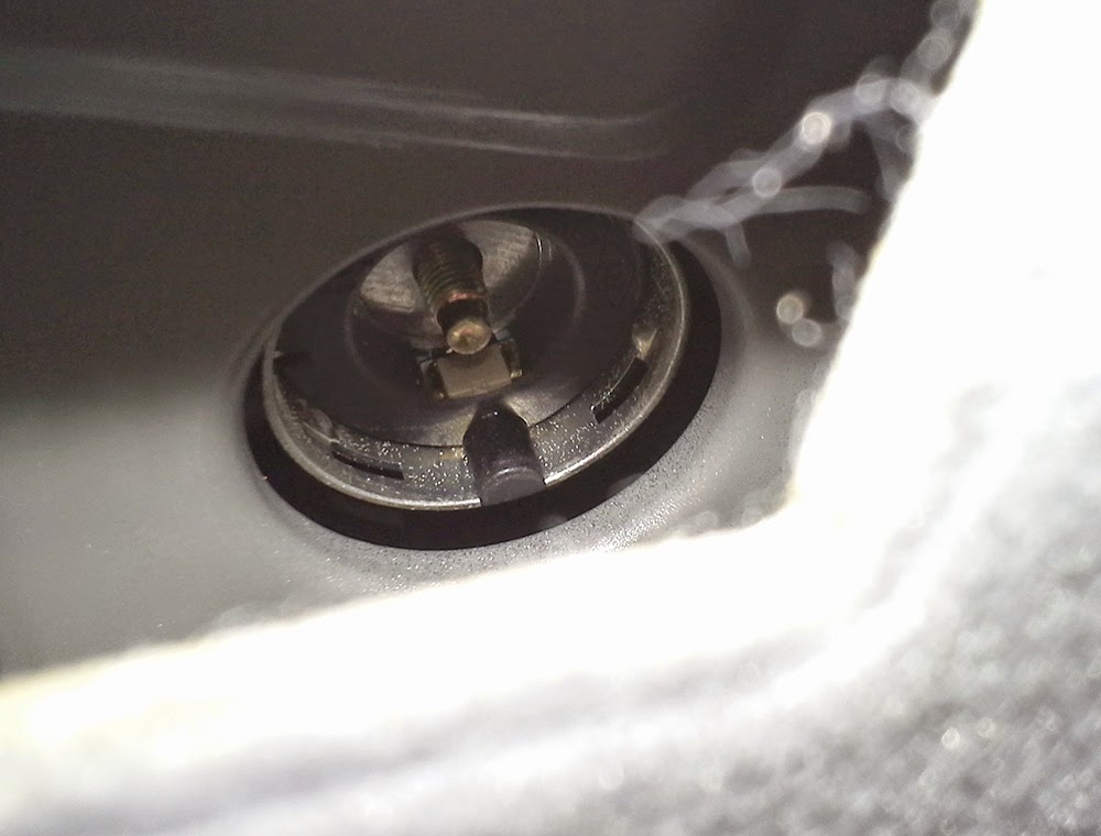

* under is the nut :

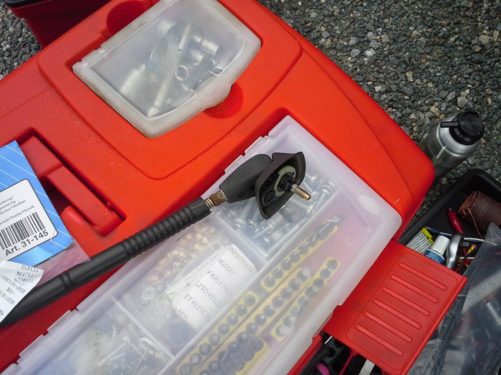

* and just take it out - PLEASE, be sure that you have the right shape base mount antenna!!

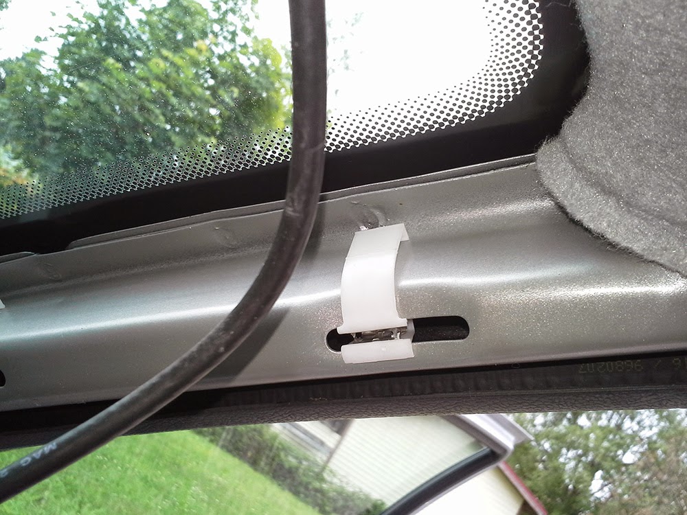

If you decide to change the cable also, cut close to that metal end the original one, attach to it the new one on it`s radio plug and plug it to the radio follow the route of the original one.
Old:
New:

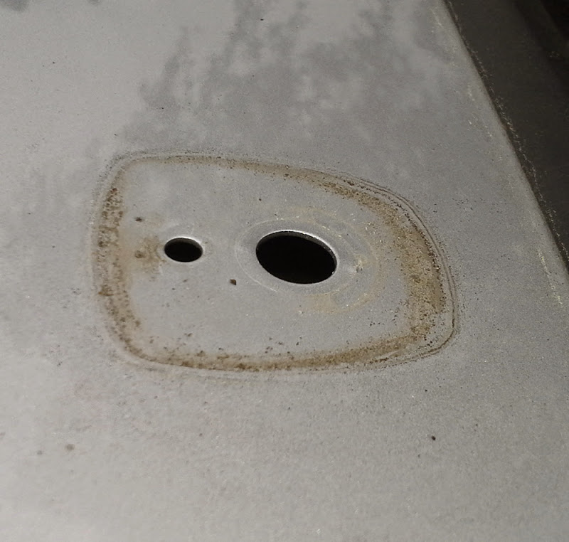

The on reverse order fit all together BUT! be careful if put back that metal sh*t cover back. I drop it inside that small area under the antenna and there hopefully was small U-shape hole that i pull it through via wire.
