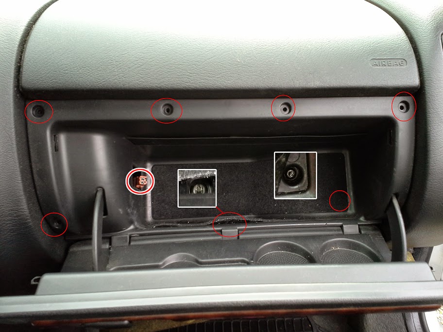

What to do
* With Torx 20 remove the screws on top(in rubber covers, do nto remove just do it trough their holes), then that in left. Under the matts there are other 2 marked with curcle.
* Take gently out the light and it`s cable plug
* pull little the hole unit and deattach light off switch plug, and cut/or remove the cable holder in behind
That is :wink:

For "CAD" cars, the glovebox light is a small supplementary harness that may be unclipped below the glovebox. Otherwise they are very similar.
