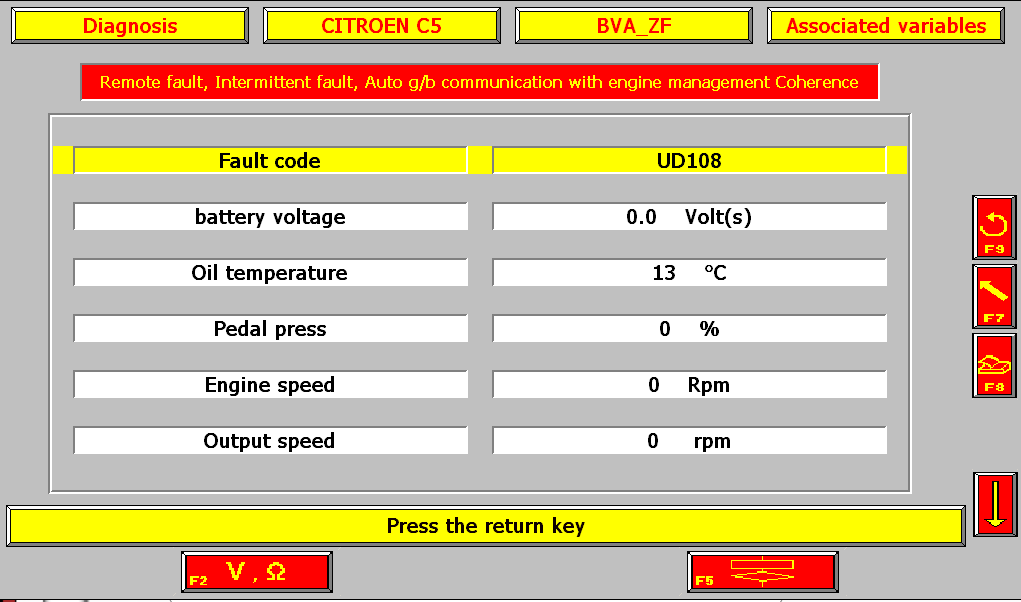

Had a visit from Bandit12 today to pair a new key up for him.
Was an interesting visit, and proved that my Lexia worked with a different C5 (a 2.2 HDI auto) :D

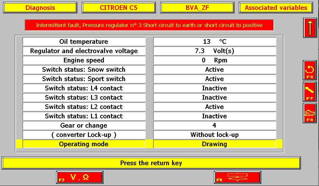

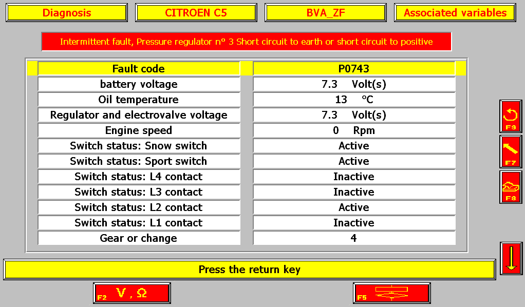

Anyway doing the general run through of faults, there were a few that appeared, most notably was some Auto gearbox ones.
Here are the lexia screenshots:
Cleared them all now, so hopefully they were just one offs. But has anyone seen these ones before and know a potential solution? Seems a bit odd to have logged Snow and Sport active at the same time.
Gearbox has done ~118K miles, so is also due an ATF change.
2004 Citroen C5 3L V6 Auto

If they cleared and haven't returned Ben, I'd not worry. It seems quite often that these sort of faults appear all over the various ECUs and moreso on a multiplexed car...

Given that the engine RPM was zero and the battery voltage was 7.3 volts when the fault was logged I would say that it occured just as the engine was cranked! If so the battery and/or battery connections could be on their way out or the battery was flat at the time. Not surprising that the ECU would have trouble controlling the solenoids with only 7.3 volts to work with.
One other possibility is a poor power connection specifically to the gearbox ECU, did you happen to check the live voltage reading from the gearbox ECU to see if it looked normal ?

Well spotted on the battery volts Simon. That'll explain it fully :-D

I probably should have connected the dots there Simon too.... there were a few other faults logged that I was putting down to possibly disconnecting the battery before things had a chance to shutdown... as there were a number of "lost communication with X ECU" etc.
The other thing I did say to Bandit12 was that these faults *could* potentially be from years ago as he said the car had been sitting still for quite some time (he's only had it about 6 weeks, and the previous owner had left it dormant for a while - a couple of years I think).
I think I could actually wager that all these issues have come from the previous owner when they were reviving the car back from its deep sleep!
We didn't go off for a drive in the car to see if any of the errors reappeared, only a second crank.... but going by what you have said Simon, it would stand to reason that the issue most likely only occurred when cranking.
We are going to try to meet up again when I'm next over (most likely to do his ATF change), so can recheck after he's driven it around for a couple of months, but I'm now fairly confident that the error(s) won't be back.
