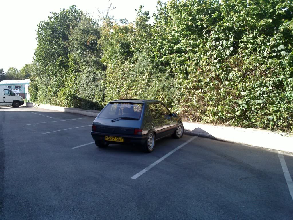

Hi guys I've got a 205gtdt, lowered on avos alround, full gti leather and boost turned up. The 1.8 turbo has developed a crack in the cylinder head, so I bought a 306 dturbo motor to slot in (1998) question is do I have buy a 306 power steering pump and because of the top mount cooler will the bonnet shut or will I have to route it for a front mount?? Do these engines go in easy enough??
Piccy of my puggy

Can't see the badge, is it a D-Turbo or a XRDT ? , Was not aware of a GTDT model. They did make a Sceptre DT as well, these were 3 door. The GTi style body makes me think its not factory, never ever seen one with that from the factory.
